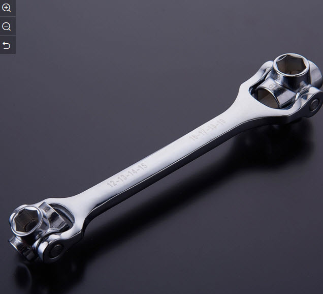

Actually, I never did figure it out. I tried all of the wrenches I had and nothing worked. After I got it all buttoned up I remembered I had one of these combination "socket" wrenches and was curious if it would do the trick.

did it? also just saying I stood on a ladder in a 90+ humid shed with no fan in the world enough to not profuesely sweat and i craned over with just one arm to reach the bolt on the hold down and this truck sits high and im not tall :( I got the bolt iwth a swivel ratcheting box end wrench. broke it free with the jaws(THANKFULLY IT WORKED FOR THAT) then the rest was little by little ratcheting and i got it. I did not install it very tight and will have to tighten more if i ever get roading with it. but it needs to be timed before I tighten it lol so it will stay mostly tight till I can get to that
