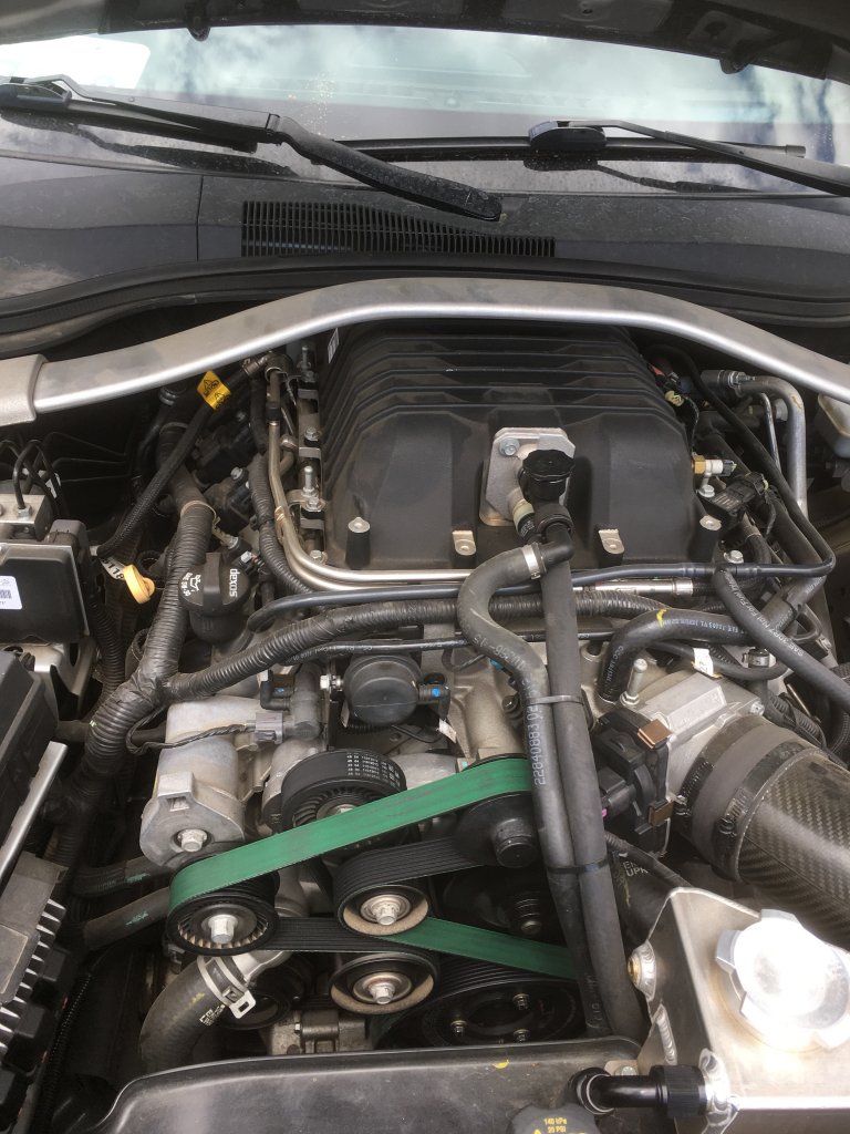

I have two buddies that have supercharged ZL1, fast as all get out, but gas hogs. Also hard to work on. Dang, have three videos, but won't load. Boy they sure sound cool!

YEAH they seem to throw belts and wipe out jack shaft bearings, throw balancers off etc with aftermarket installs sometimes, but man I guess if gas mileage is your main concern then IDK probably a single turbo as i still get the same 13 mpg from my 5.3 with 600 whp vs when it was stock with 200 whp but if I drive it like a TT should be Im sure it’d be less than 10 mpg
