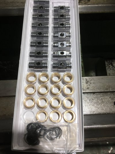

My 454 in the K20 is awesome, except the gas mileage. That excuse brings me to this subject, LS swap with a single turbo. I am a machinist by trade, 40 years, retired. However a longtime shop where I trade needed a machinist, so now I am the guy that does all the internal work, (bore, hone blocks, and rebuild rods.) I have been enthralled with turbos, but never had one. My goal is (of course) more power, reliability, good winter manners. Since I have the ability to do all my own work, it will save me $, and I can make it like I want. SOOOO,

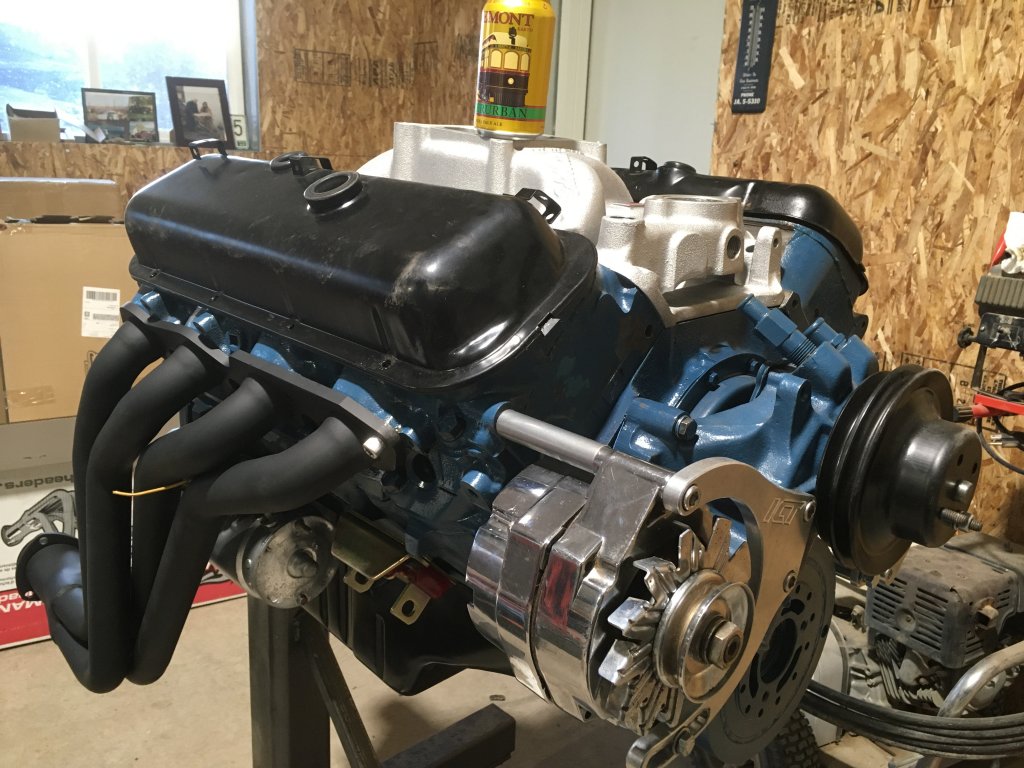

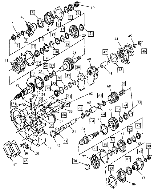

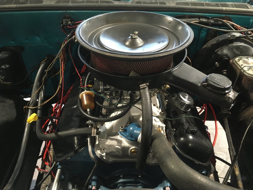

Here are a couple engine pics. 1999 LQ4, the big boost queen. 4l80e transmission. I have purchased a transdap to mate the 4l80e to my 205 TC. The 205 modifications will be input shaft and larger bearing. This will require the TC teardown, and case boring to fit the larger bearing. While in there I will reseal, and replace anything that needs it. That will mate the trans to the TC. The BBC pic is what I am replacing with the LQ4.

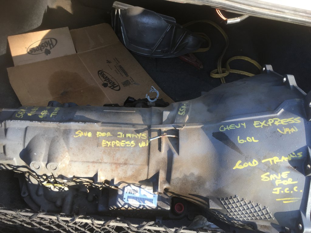

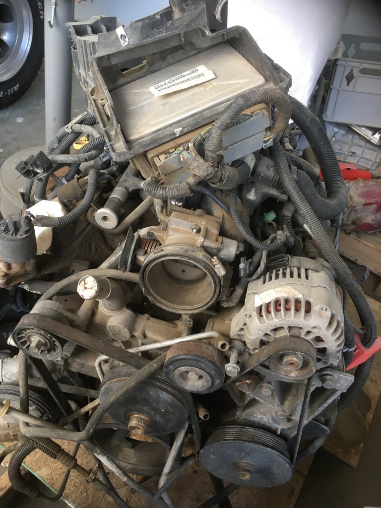

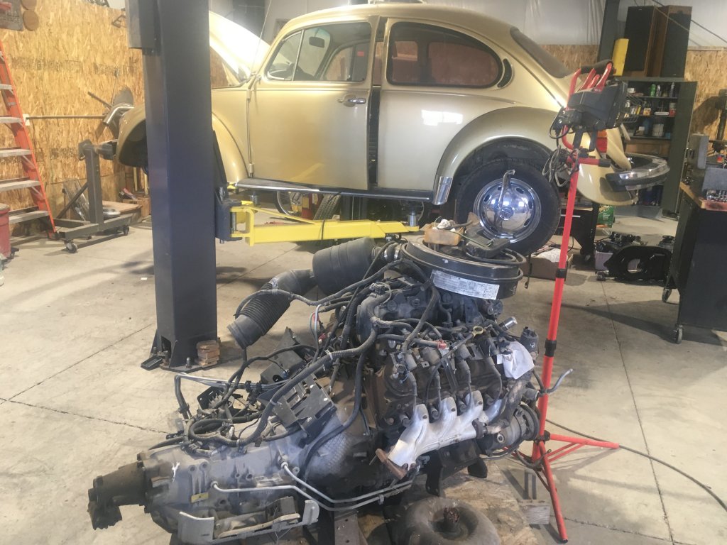

Here are some doner engine pictures, out of a 1999 2500, all wiring, ecm, trans, complete for $1500. The tailshaft on this trans will be replaced with the Transdap unit, thereby allowing the trans to bolt to the 205 TC.

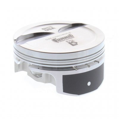

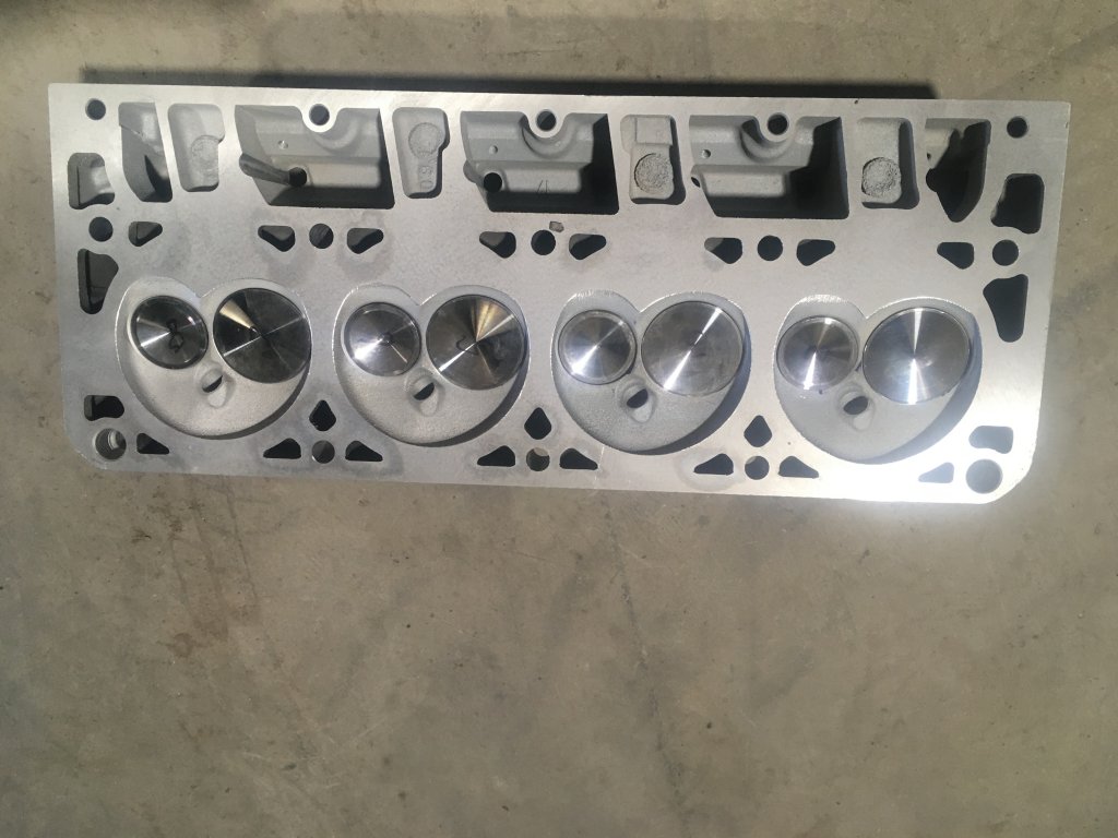

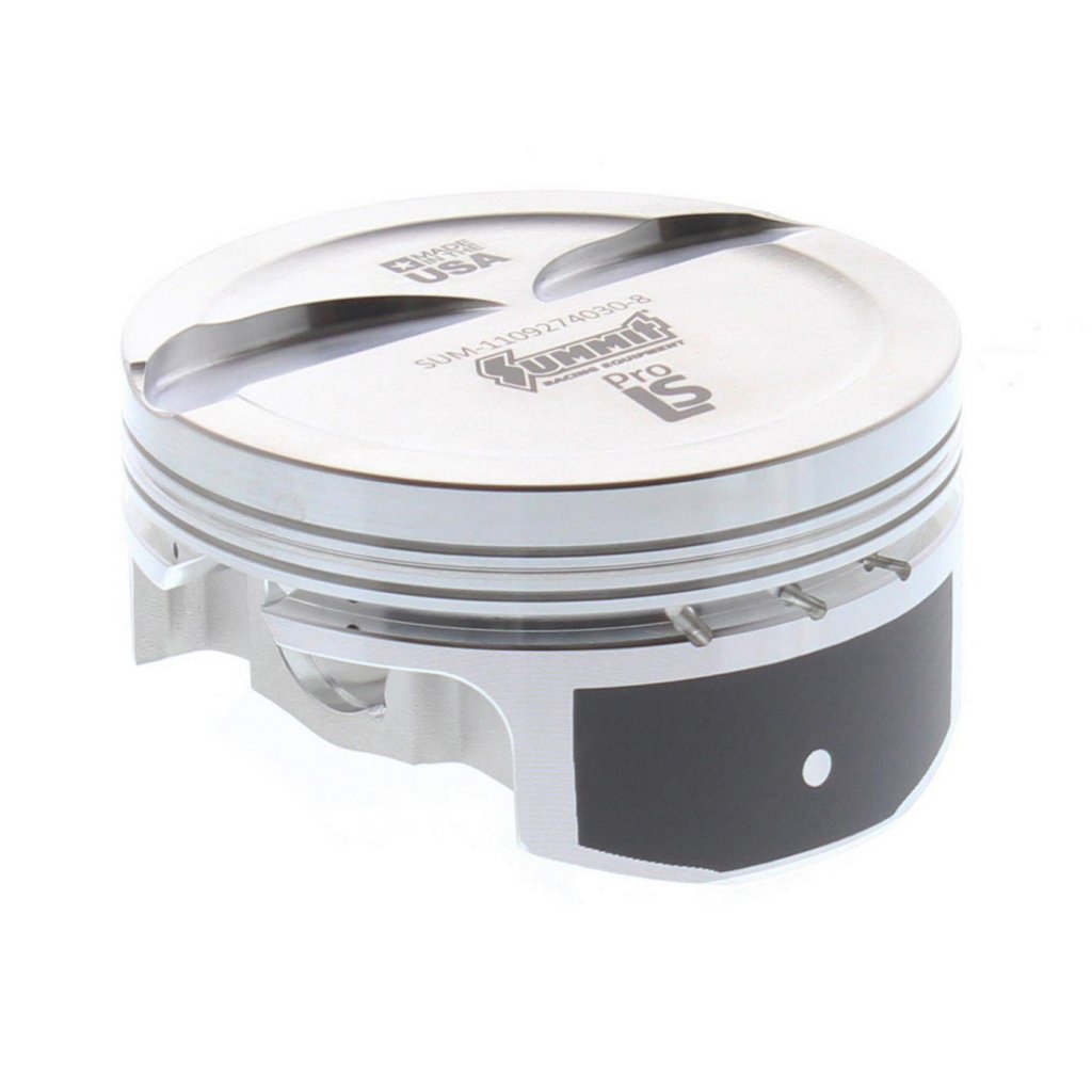

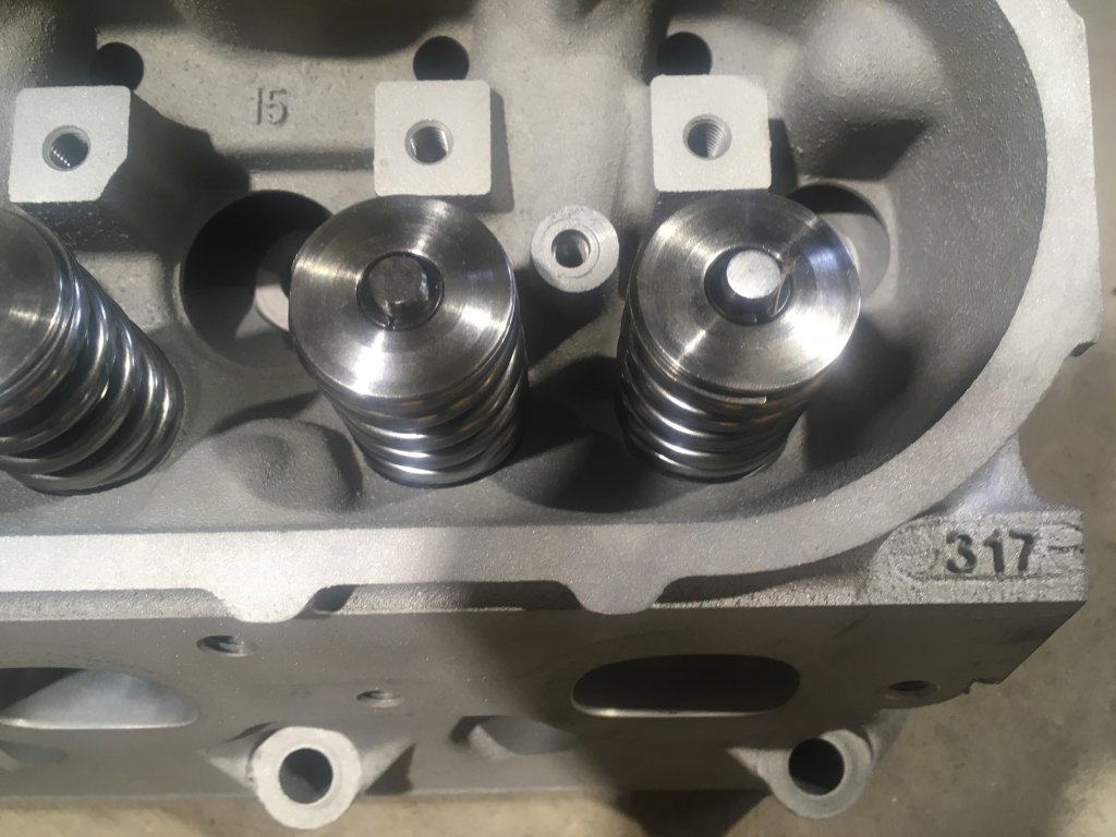

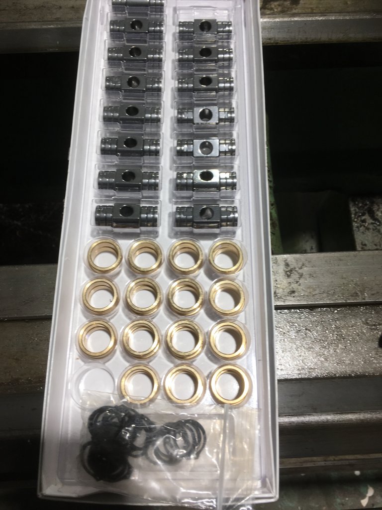

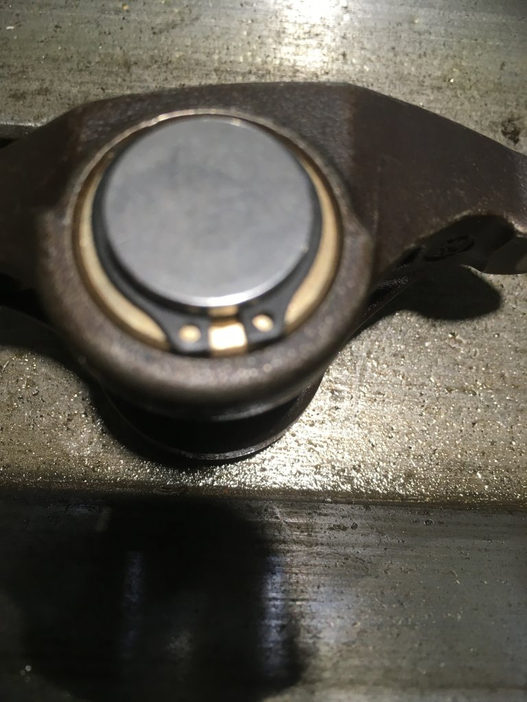

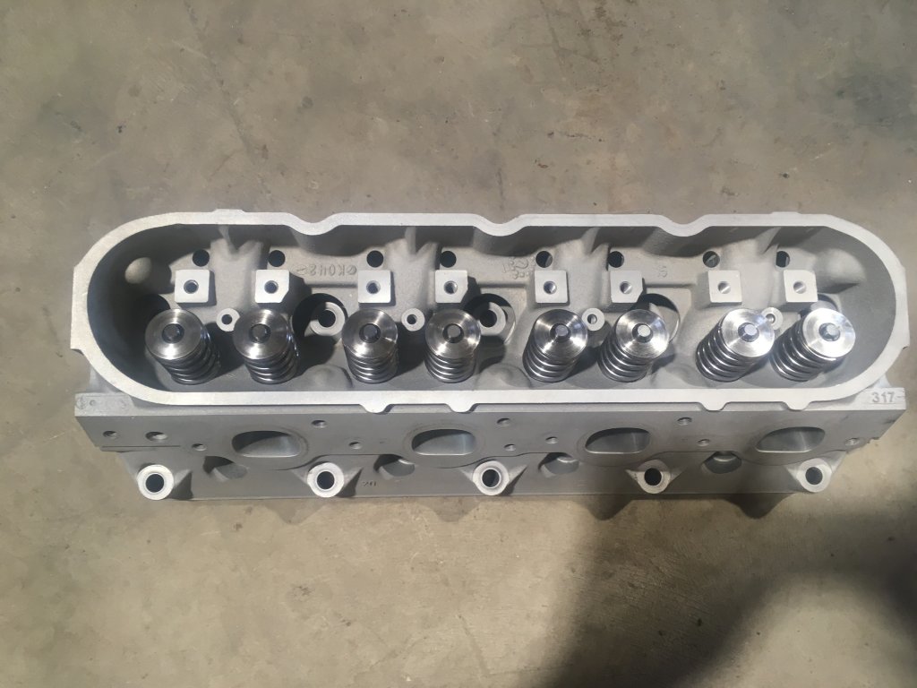

I have addressed most of the weaknesses of the LQ or LS motor. 1) Trunnion kit, 2) pistons, will use a quality 2618 big dish piston, target compression ratio 8.5 ish. 3) iron heads, replaced by these 317 74cc CNC ported heads. Porting done by Katec, $500 + shipping. The valve job was done at the shop I work at taking into account that this is a turbo build, so valves that can handle the heat.

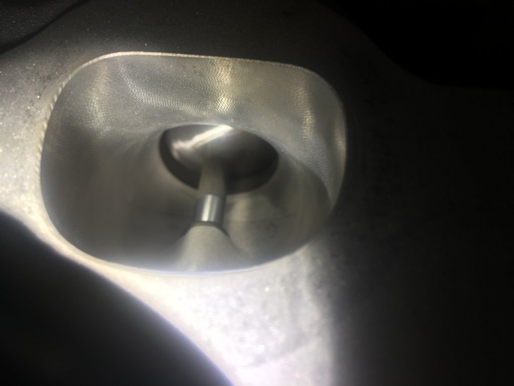

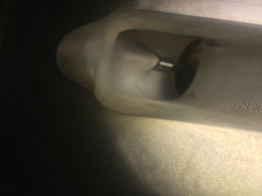

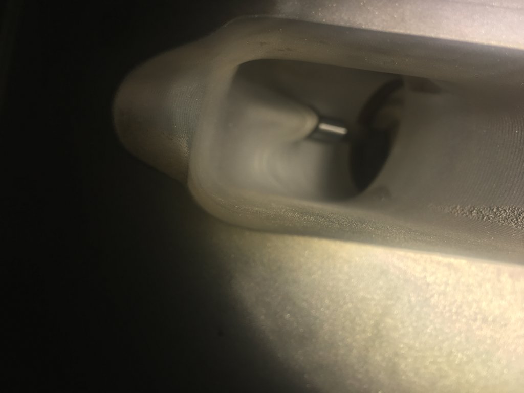

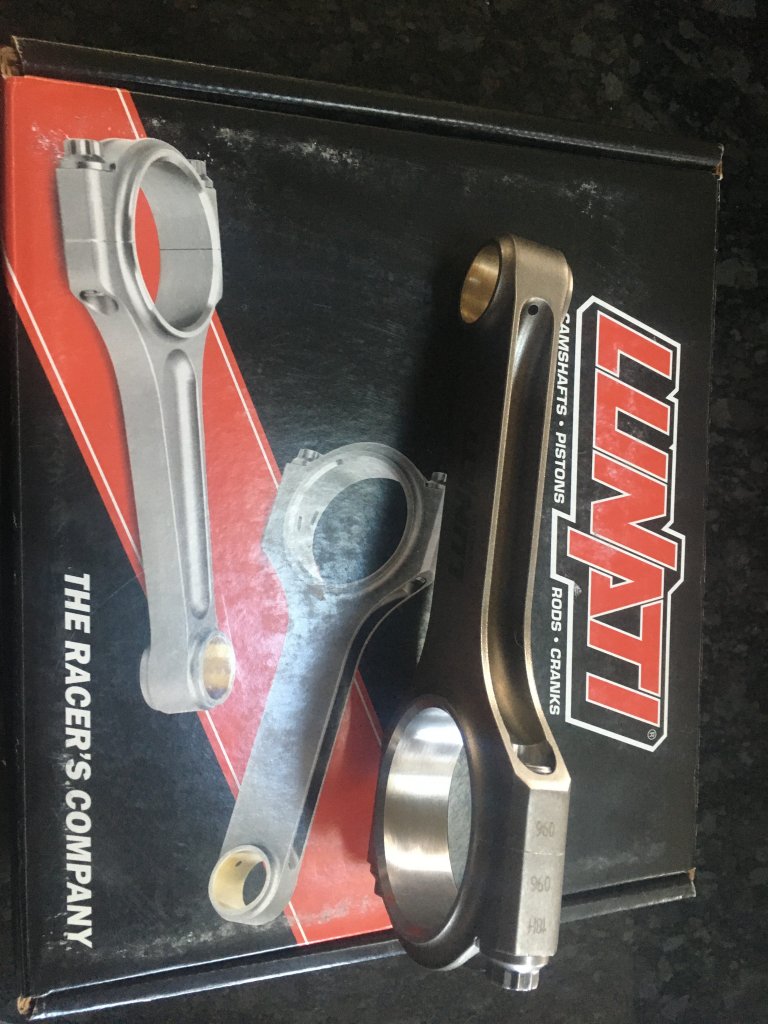

4) While the stock rods are pretty good, you know how it is..."lets just turn it up a little bit more," So I will use these 6.125 rods. Tried to get a good pic of the porting job...

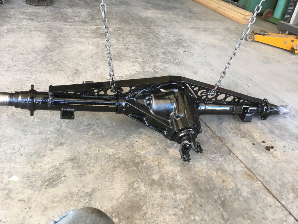

I have already gone through the 14 bolt FF and the D44 front, think I am good there. I will use the truck intake, and FYI Heads flow 320.

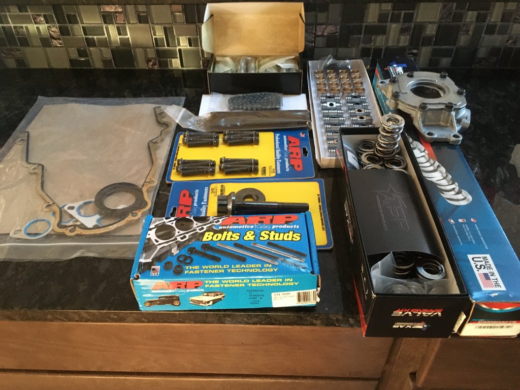

The motor also has ARP bolts for the mains, and heads. New oil pump, the late model Hyd lifters, and good timing chain. May need a pan, we will see.

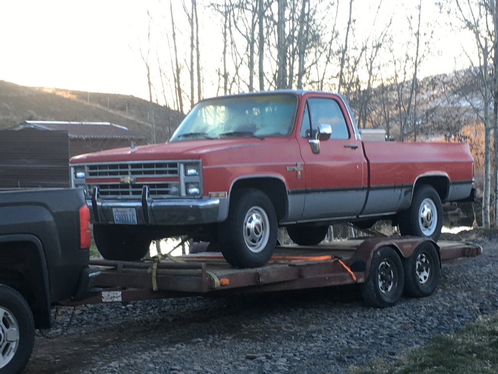

I have a selection of squarebodies,
Not that one, these, but I like the boots....
