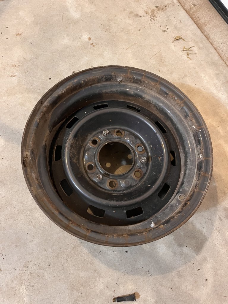

After measuring. These are 15x7 and stamped 15x7?? They are 8” outside to outside but 7” bead to bead.
legopnuematic
Licensed Junk Dealer
Oct 27, 2016
3,315
9,518
MO
Spencer
Wheel width is measured bead seat to bead seat. Not gospel, but the overall width on steel wheels is generally about an inch greater than the width is, as you measured (8” overall, 7” seat to seat).
