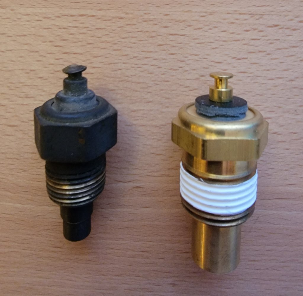

A while back, I was trying to get my temp gauge working quickly (trying to get her back home), but wasn't having any luck, so I installed a cheapo aftermarket kit from the local parts store, and all was good (other than her getting hot on the highway when I run the A/C). Now that I've got a few hours to tinker, I'm going back down the path of getting gauges working again.
The sensor that came out looks to be a 1/2" npt, with what I would call a button type of connector. When I went to the LPS, all they had was the sideways spade type, so I ordered what I thought was the right sensor, a G1852. It LOOKS like the one I've pulled out, but it's got a larger diameter thread, and the sensor itself is larger in diameter as well (going to post a pic here in a sec).
I don't recall if there was an adapter in there, but it doesn't make sense that there would be.
Should I just go back and grab the smaller sensor that they have in stock and modify the connector to fit or keep trying to find the right one? I worry about the ohms of resistance in something other than factory stuff...

That's exactly what I bought, but it's too large. Won't fit in the coolant hole. ;)

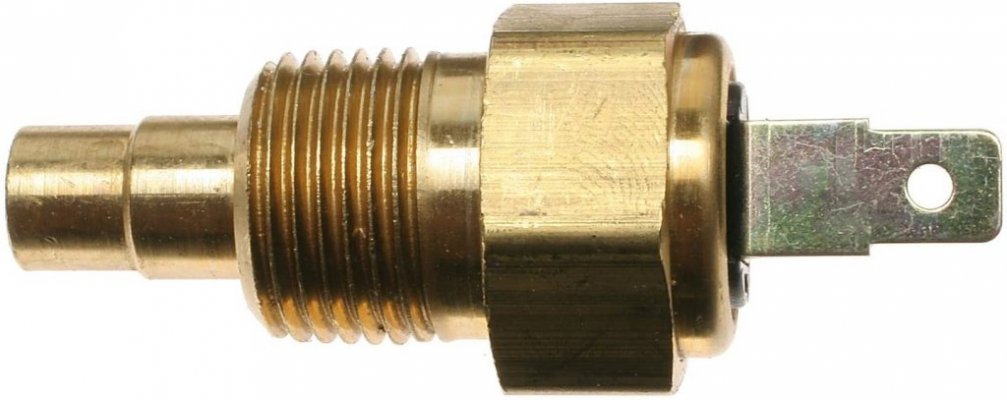

Okay, that makes a lot more sense now. I obviously couldn't install the larger sensor, so I found the one shown below at the local parts house. I was trying to test it with boiling water and see how it would change the resistance. Never changed a lick. The sensor showed open the entire time. Next test will be to wire wrap the threads and connect it to ground, connect the spade connector, and place the sensor in boiling-ish water. See what I get (if anything), and compare it to the aftermarket gauge I have installed.
Thoughts?
