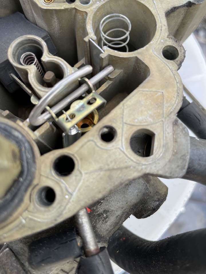

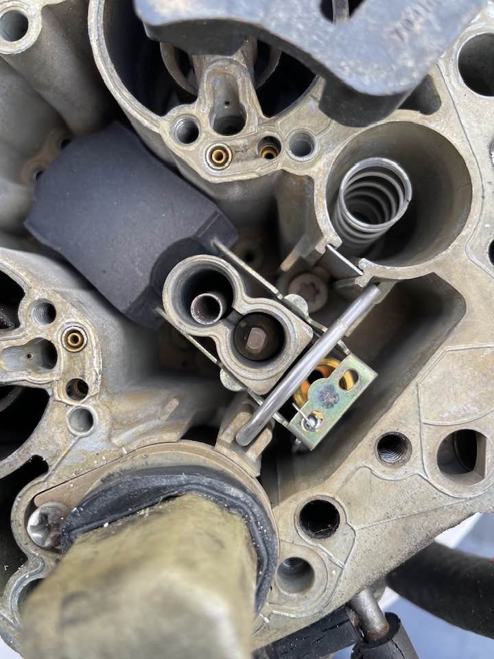

My new to me 1985 ran poorly but did run. I've removed the heads and started the Quadrajet rebuild. Just pulled to top off to find......
All 13 top plate screws were finger tight.
It appears the pull-off man shaft was not through the choke lever hole inside the main body.
In the pictures look at the float assy. See anything unusual?

Q-Jets are junk!! I just rebuilt it and it still doesn’t run right!!! Get a Holley!!
With that standard of mechanical aptitude, it’s no wonder Q-Jets hace the reputation they do.
How does anyone who hopefully knows which end of a screwdriver to hold make a mistake like that???
I’m surprised it would run without flooding. I figured you would have had fuel coming out the vent Old Faithful style.
Hopefully you have a quality rebuilt kit Cliffs Q-Jet is probably the best out there. I don’t know if he offers parts for the CCC style carbs. He can probably offer some tuning parts to improve on what you have. Keep in mind, the CCC carbs have some special tuning procedures.

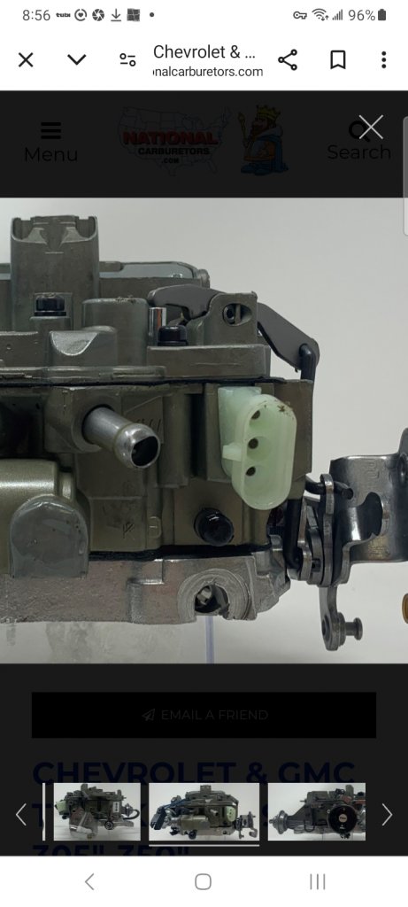

Doppleganger
May 24, 2019
12,650
58,627
OH-MI: Just like it sounds
Mine is also an 85 and had that same QJ. I sent it to Mountain Man in AR and they did a stellar job rebuilding it. Problem was, the idiot PO cut all the wires under the hood so I couldn't use it anyways (without calling NASA) - so I went FI and the 'new' QJ remains in the box.
5,350
8,523
@doppelganger @Geoduck doppelganger picture is of a dual capacity accelerator pump qjet, not a computer controlled qjet. Almost identical to a standard quadrajet and will run fine with no electric inputs except for the choke. @Geoduck Is this the carbureator you have? Not one with a mixture control solenoid and throttle position sensor. If so that would explain both of our confusion. I looked at the title and gave you instructions for an actual computer controlled quadrajet.If this is the carb you have and rebuilt it like a standard qjet,it's going to work fine. Damnit ,it's that year make and model thing, ccc was California only 86 only to the best of my knowledge I could google it,to double check,that would make some members happy.

Well it's good news if you or a friend ever need a qjet for anything, the grey plug on top just controls accelerator pump shot disconnected you'll just get a full shot all the time. If you want to hook it up that's not hard either,but old school qjets were full pump shot always..
This is the tell tale of a ccc qjet a plug for the tps
