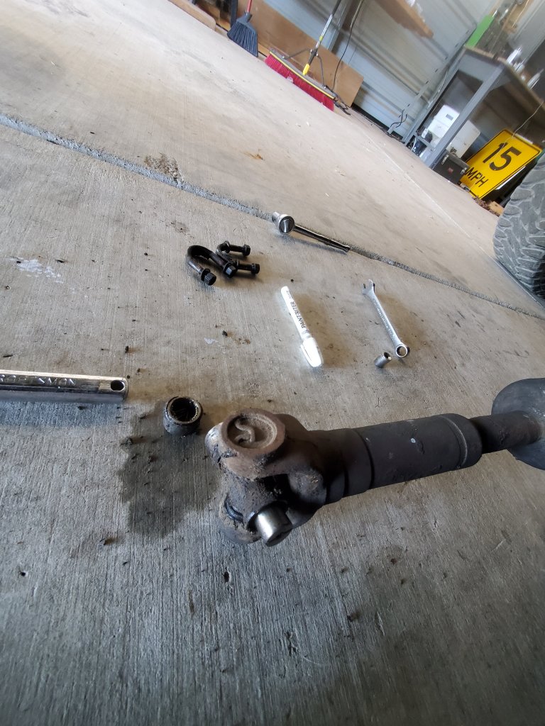

So I took my rear drive shaft off this morning, I'm not sure what this part is called.. but is there supposed to be play here?
gotamotor74
Jun 8, 2023
28
26
california
tyler
k25
A video would be better not sure how to post one. But the part that holds the ujoint thats attached to the driveshaft.. is wobbly

You probably figured it out. Rear driveline slop somewhere.
When locked in 4lock, the front half is taking up the slack (literally). Doesn’t sound like a clutch issue. (Per your title)

Hoping so. there is a little up and down play in what I discoverd to be called the slip yoke. I discovered that the slip yoke is... supposed to slip, when I found out the mine was well... not slipping... it was pretty tough on there, my first time messing with a drifeshaft and I thought I was all just one piece at first. I'm hoping the up and down play is normal... or that perhaps maybe I need a longer driveshaft because I hear that you need to do if you lift a vehicle? This one is lifted 6".
Current plan is I got new u-joints, going to put them in, completely cleaned everything up. Got all the old 40 year old gooey glue grease out of the slip yoke, cleaned the 40 years of dirt and grease out of the splines on the driveshaft... I am in current search of the little cork gasket that goes as a seal on the slip yoke. But once I find that, going to put it back in and we will see if any of that makes a difference...

Replaced both u joints on the rear driveshaft and cleaned up the slip yoke. The yoke was pretty crusty and nearly un-slipable.
Clunk is still there
Going to move to the front driveshaft components next.

If the slip-yoke had up and down movement, I'd replace it. Unless the output bearing on the x-fer case is shot.
