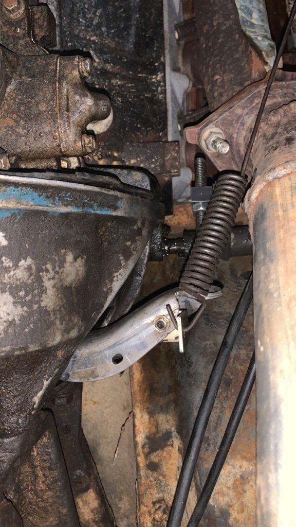

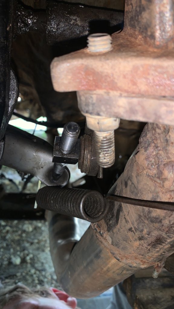

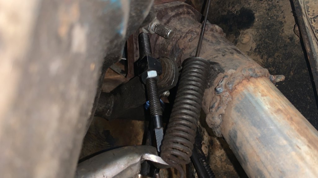

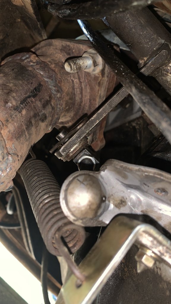

The was never a rubber boot, I got everything from LMC I don’t know what happened with the boot could’ve been dude being frustrated I don’t know I didn’t do it. The throw out bearing was the 1697C. Here’s current photos

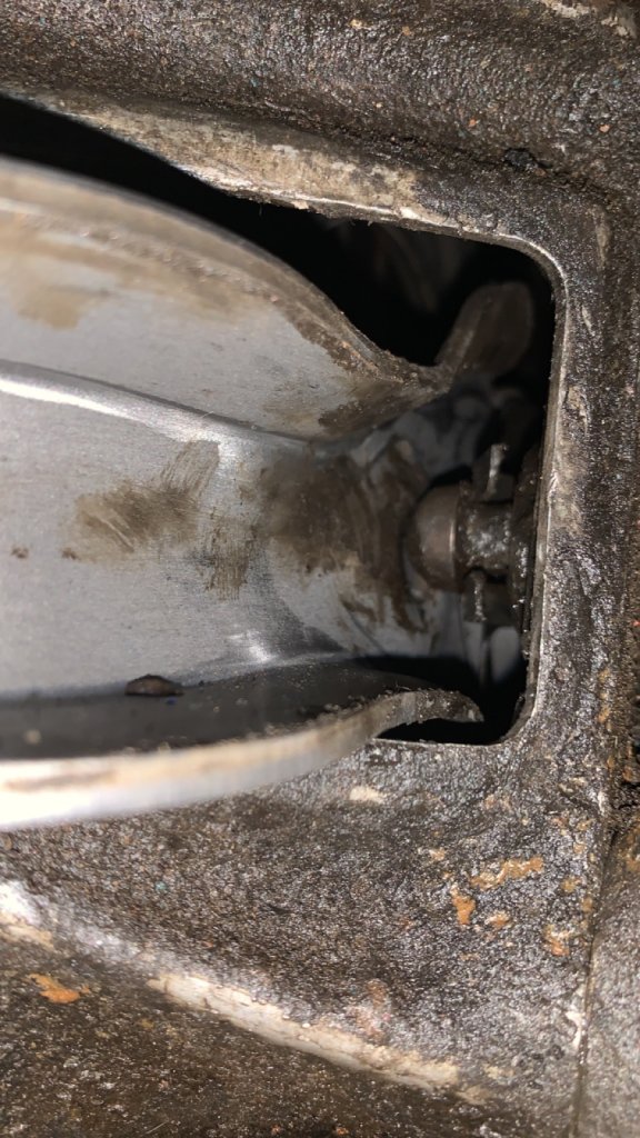

On page one has two prior photos, right now the only issue I can come up with is the fork doesn’t want to stay on the stud like it should and as you press the pedal is rotates down a little possibly? I’ll have to watch it as someone else presses the pedal. The spring was originally ran to the motor mount and that had a downward angle on it and the fork was rubbing the bottom of the opening in the bellhousing and changed the angle of the adjustment rod with every press and release of the pedal. I believe the throw out bearing was the correct choice since I went from little to no adjustability left to what’s shown in the photos, the lmc adjustment rod was 1/4”-1/2” longer than the factory rod aswell. I changed the return spring to a hole in the frame by the shock and it helped the angle quite a bit, I don’t have a factory, unmolested truck to check the differences with so I really don’t know what all springs I’m missing. I know the little spring under the dash to fully return the pedal is missing, I ordered it but it didn’t get installed and is no where to be found. I’ve read about some people having small springs holding the adjustment rod and fork together, I’ve only got one long spring from the bottom of the fork to the frame(now)

THe small spring to hold the adj rod togerther is just that it keeps the adj rod from falling out of the clutch/ just go to the hardware store and buy a middle size spring and put in there if the spring isn't long enough then just hook a pice of welding rod to it. as far as the spring under the dash goes I don't know of a small one. There is a big one.

Post 6 and 34 show the attachment to keep the fork on the stud. The clip on the fork looks better in post 34, but not great. Did you replace the fork or just bend the clip back to somewhat straight? That clip is what keeps the fork holding tight to the pivot stud. Did you change the pivot stud?

@DoubleDingo I had the fork replaced with a new one from lmc. The pivot ball was not replaced it was out of stock. Yes it looks better and with the spring attached to the frame it’s even better but it still has a little up and down movement. I drove it to work and back today without any issues other than it engages a little high for my preference and I over revved taking off a couple times.

Okay. I'd expect the fork to ride tighter to pivot stud with it being new.

It does hold tight when everything is resting up right. After you press it and it returns is when the issue occurred. It currently works fairly well other than I’d like it to start grabbing close to the floor, and the spring rubs the adjustment rod since I have it ran over to the frame. I don’t know where to hook it up to that’s higher than the fork to keep upwards tension on it.
