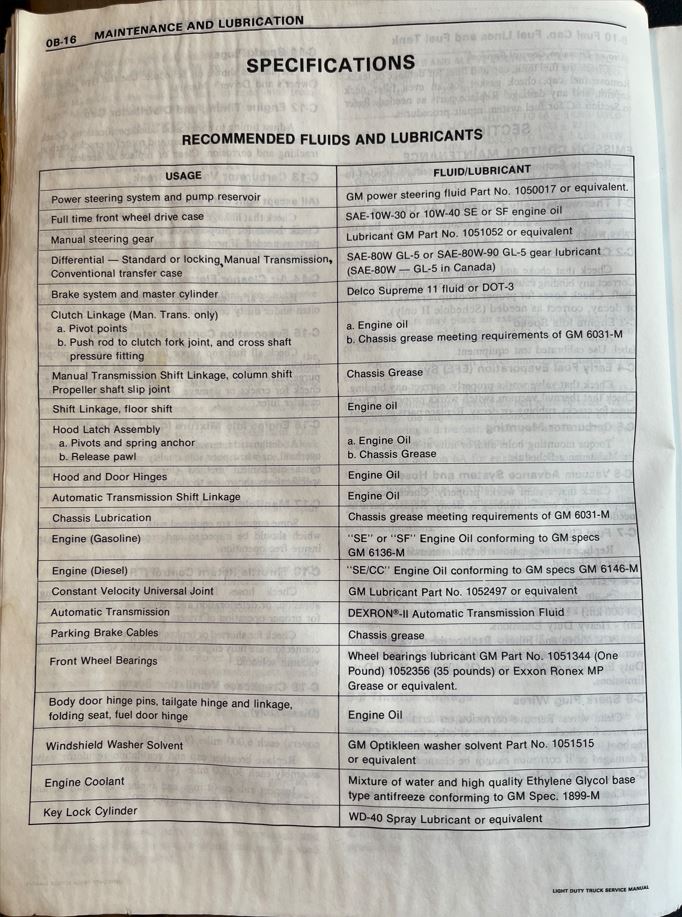

I found an short post outside of GMSquarebody.com that states "most GL-5 lubes are now compatible with yellow metals IF it has a rating of "MT1". Early GL-5 lube may have been corrosive, but, most of the new GL-5 lubes have counteractive agents to any sulfurs that reside in the oils".
This post didn't provide anything to back up this suggestion. Does anyone have anything else to add? I'm still struggling with the idea of using GL-4 instead of GL-5, when the 1980 GMC Service Manual explicitly states on Page 0B-16 "SAE-80W GL-5 or SAE-80W-90 GL-5 gear lubricant" for "Manual Transmission, Conventional transfer case".

Actually, that's what I wound up getting. Partially because Amsoil has an excellent reputation, partially because when using the Amsoil website and specifying "1980 GMC K1500 4WD PICKUP 5.7L 8 -cyl Engine [L]" and "For Manual Transmission: 4-SPD GL-5 All TEMPS 80W-90,80W", it tells me to use SEVERE GEAR® 80W-90. As I mentioned above the 1980 GMC Service Manual also explicitly states "SAE-80W GL-5 or SAE-80W-90 GL-5 gear lubricant". Also, I read somewhere that the MT-1 specification that this product meets eliminates the concern about GL-5 being corrosive. Sorry, don't remember where I saw that.
If I remember, I'll let you know in a month or two where I'm at.
