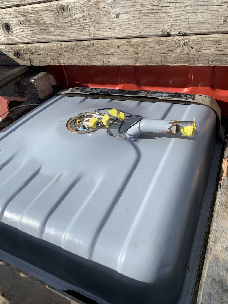

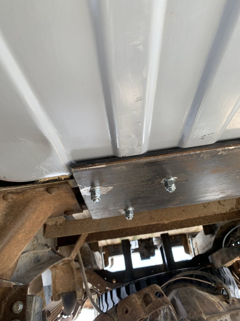

One of my dual tanks in my 79 K20 developed a rust leak while I had it out cleaning it up, replacing the sender. So I thought this would be a good time to swap both tanks for a single and I got a 31 gallon tank from a 75 Suburban. Both type senders should work with the gauge as both are 95 ohms max. I made mounts, just by bolting 3 pieces of 3/16 plate steel to the underside of the crossmembers, one of which is under the rear of the cab. The tank will fit in ok. I haven’t driven this much since I got it and am just curious if there’s some reason I’m not aware of to stick with duals. One issue I have with duals is that to fill both up you have to hang up the spout and move the truck. The other issue is safety, having the tanks outside the frame. This is a flatbed so there isn’t even any body metal for protection. I have read however, there have been few fatalities over the years from this. On the other hand, the roads here can get icy. I would much appreciate any opinion on your preferred tank setup as I am “ six of one half dozen of the other”.

I saw somewhere the rear center recommended but I hung my spare tire there with the little winch, so put it between the two crossmembers behind the cab. I’ll put up pictures in a few weeks. It’s kind of close but I glued some plastic and rubber here and there, ran the straps over the top instead of underneath, and made strap type shackles instead of 1/2 bolts holding the 4x4 wood frame bed down in order to give me 1/2” more space. Also since the bottoms of the crossmembers are off level by 1 1/4” I put a spacer of aluminum bar on top of the rear mount ( plate) to drop it 1/2”.
Just in case anybody is interested.

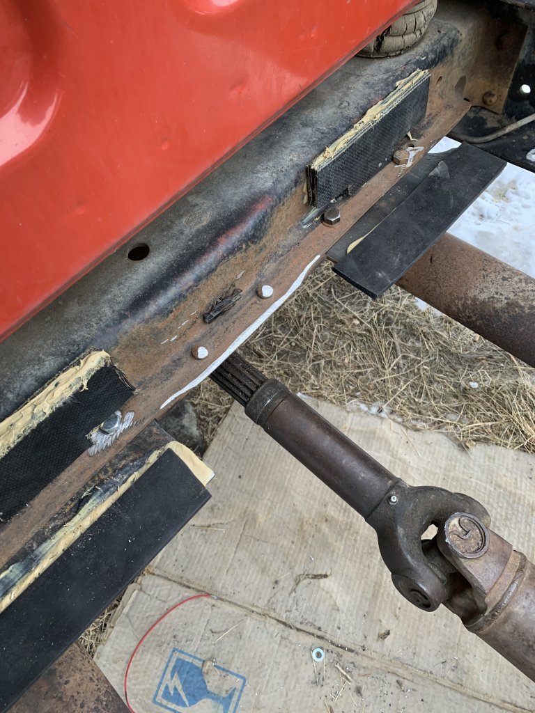

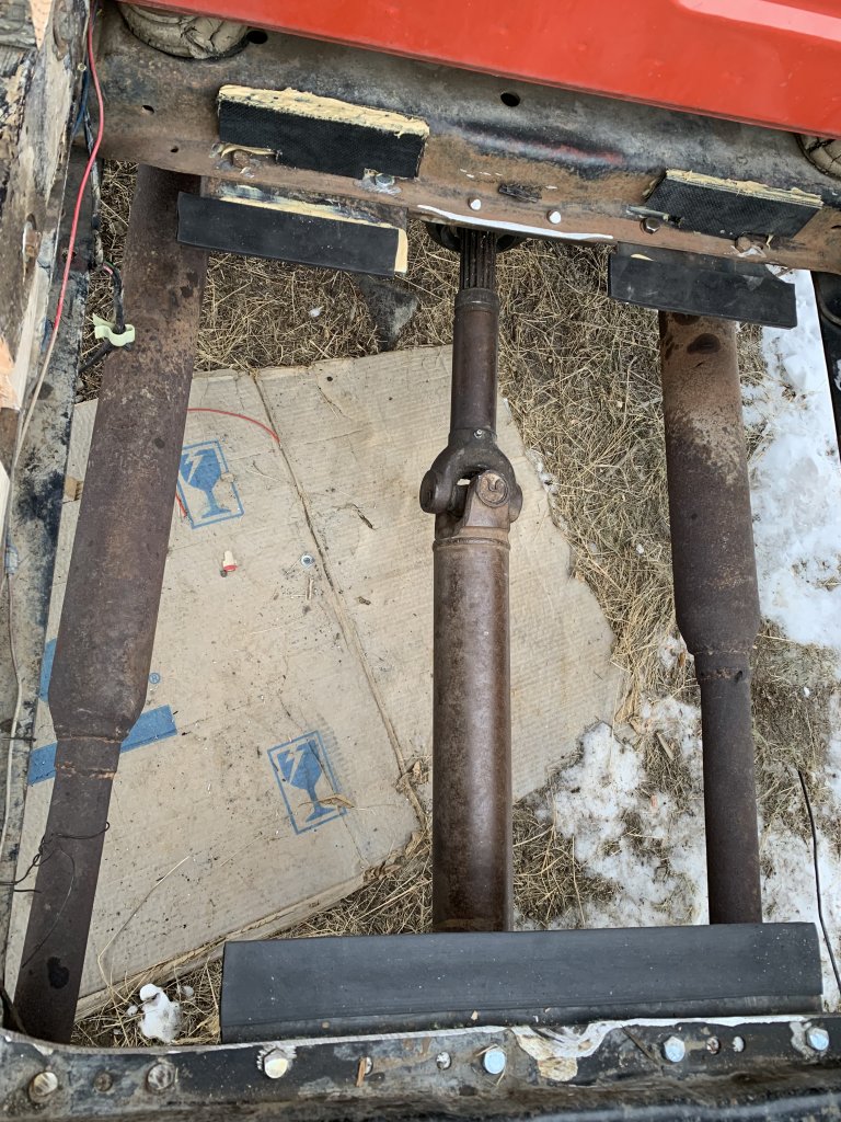

I thought the burb tank went between the rails behind the axle. How are you fitting it behind the cab without interfering with the driveshaft? We're going to need pics of this contraption.

Ill see if I can get pictures posted from this phone but may need to wait until I get to my computer in town. Look at your cross members, I bolted 3/16 plate to the bottom of the hat, so to speak. The crossmembers are made of hat channel. My three plates each bolt to both sides ( both brims) on the crossmembers, for strength. They extend 3” to give the bottom two edges of the tank that are parallel to the inlet pipe, a place to sit. I used liquid nails to glue topper weatherproof rubber into those plates where the tank sits. To keep the tank from sliding forward I glued two layers of conveyer belt rubber to the side of the front member that the side if the tank would otherwise touch. I did not grind or modify the tank in any way. The spout goes to the right side like in the Suburban. The straps keep it from moving side to side. Last thing is to fill the 1/2” space left between the rearward crossmember and tank. After snugging the tank forward to the two rubber stoppers of conveyer belt I glued another piece of rubber belt to a piece if angle and put the two between tank and side if member, and drilled holes throo the other, horizontal, side of the angle now resting in top of Xmember, throo Xmember, bolted throo both with 5/16 bolt. It’s easy to access that rear angle/ rubber stopper cuz it’s wide open from the rear.
Driveshaft and both mufflers are about 5” below the tank, just guessing.
Both crossmembers have gussets from the channel rails riveted to them. I just put my 3/16 plates where the gussets were not. So the plates support the front and rear of the bottom of the tank.
The thing I didn’t like about it is the inlet tube will cut into the bed about a foot from the outer edge. But this is a flatbed, and I’ll have it in a toolbox. Open the toolbox to fill it up. With a sideways facing door that drops down. I don’t want the bed higher. the tube AT THE TANK is just below the bed boards, levelI’m going back to the wrecker’s to get the Suburban spout off the body. The outer 8” curves up
