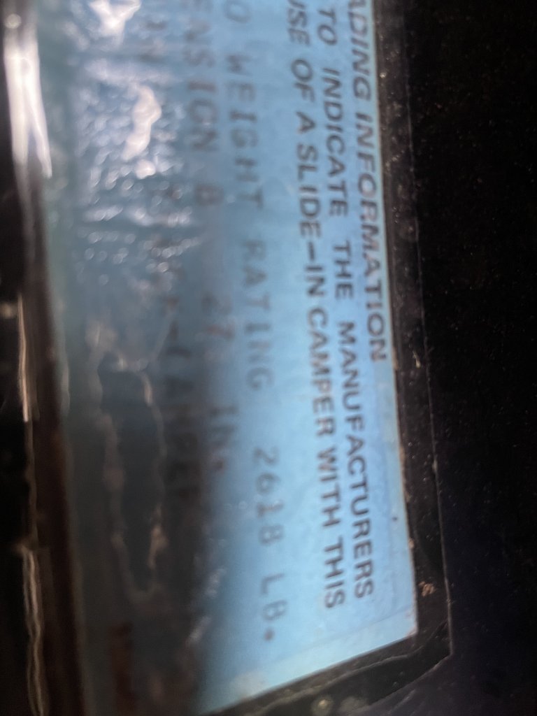

My ‘75 camper special K25 Z81 option has a GVWR of 8400 lbs and a max camper weight of 2618 lbs. There is a blue paper tag inside the glove box, to the left of the spid tag and that shows cargo weight. The 8400 lbs GVW lbs is part of the camper special emblem on the door pillar.

By accident, I once loaded my truck to 10,900 lbs when I was hauling brick to the dump. Truck drove and rode fine, but steering was a little light and I heard a few new creaks from the springs. There is quite a bit of extra capacity in the 8400 lb GVW. .
If you planned for 2600-2650 lbs as load capacity you will be well within the design capacity of a K20 Camper Special. They normally use 9 leaf rear springs and 5 leaf front springs, front anti-sway bar, 14 bolt full float axle, and at least 4.10 gears. There is also a higher level camper special option that includes something called elimi-pitch, but I think that is mostly extra supports for a a slide-in camper. The extra supports tie the camper to the front fender and the back of the cab.
