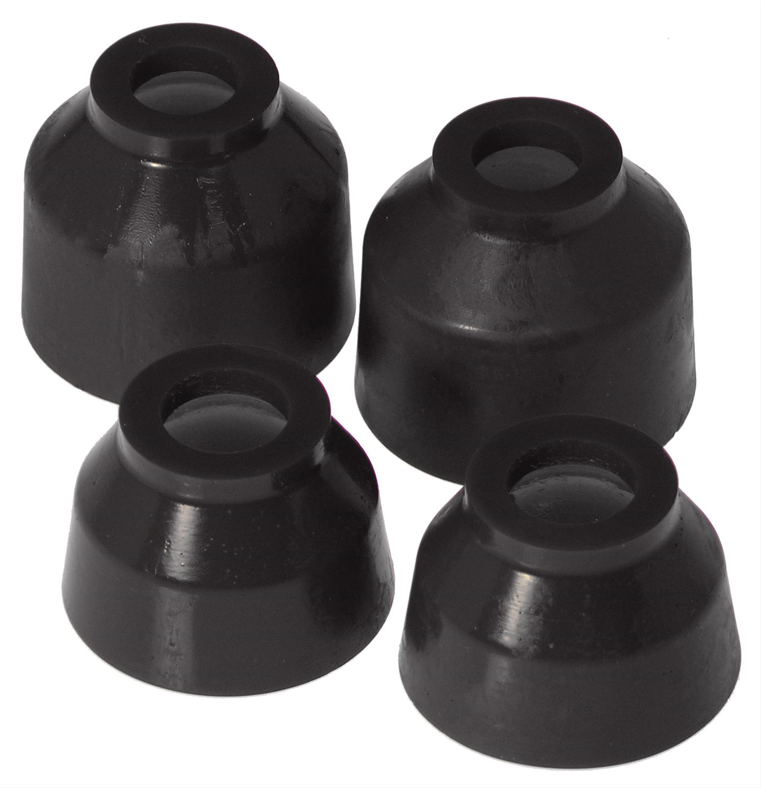

The boot is important to keep the water/dirt out. Water isn't as big a deal because it won't mix with the grease but the dirt will kill a ball joint eventually to the point of failure.
I had torn boots and put on some of these:
They're thicker and while I haven't put many miles on the truck they are currently holding the grease in place.

Maybe a dumb question but, did you remove the ball joint completely, and was it a hassle to get the old boot off and get the new boot on?
Seems like even a "cover" would work. Since you're just keeping dirt and water out.
To replace the boot/cover you do not have to remove the balljoint. Just unbolt it from the knuckle, drop it out of the knuckle and slide off the old one. If you do not have greasable balljoint(s) I would put as much grease in the cover as possible. Slide the new cover on and boly it up.

Shouldn't matter the brand. Mine were pretty easy to come off. Once the pressure is there they seal up pretty tight. And the set I posted is pretty thick so they don't deform much, if any.
