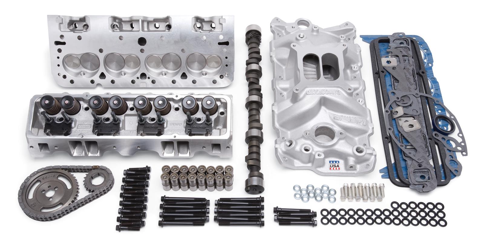

Here is an easy way to make sure the parts all match.
It's a little pricey but your almost guaranteed the advertised performance. There are more levels and other manufactures that offer the packages. I think GM still offers a Vortech package, but it is too much money in today's world.
