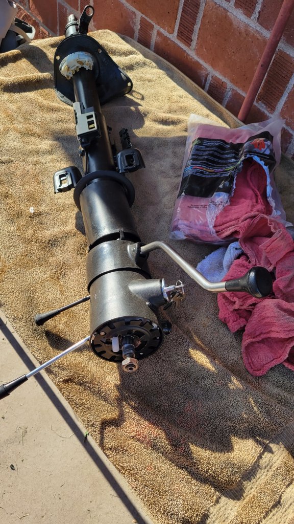

I don't know, maybe. I pulled the column again this morning - time to strip it completely down again :(

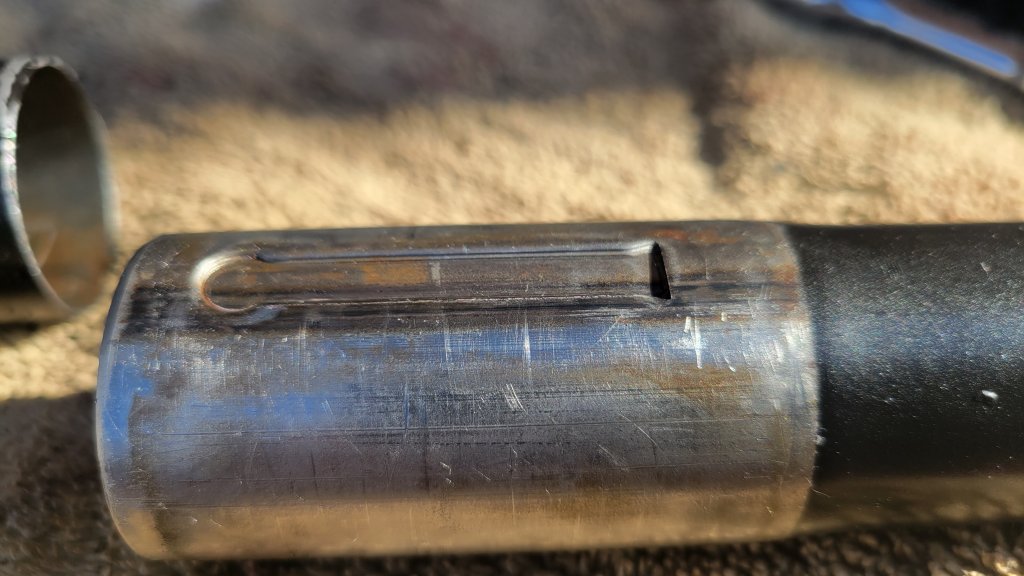

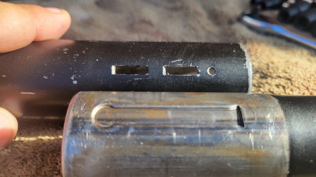

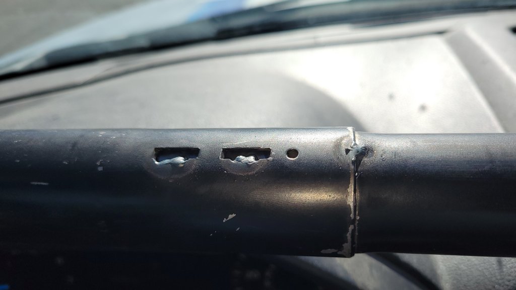

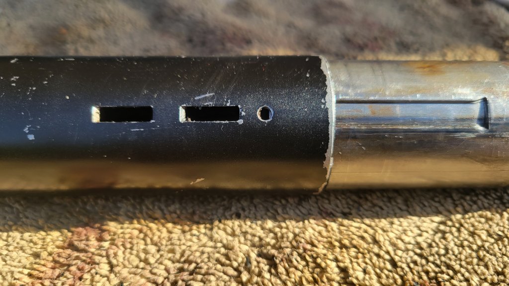

I'm just posting this information in case anyone in the future has the same issue. I couldn't find much when I was googling.
I got the column out and torn down again. On the bright side, I'm getting really freaking good at tearing and building these columns

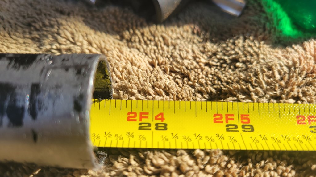

I tore it down all the way till the point the shift tube was still mounted inside the column and took a measurement of the inside of the shift tube, that way I can make sure I have the length correct during reassembly. From tube end to tube end while assembled, should be around 27-1/2 inches
Here are a few pics of the notches/keyways on the interior portion of the tube, and where they line up with the exterior portion. I think I'm either going to use JB Weld or maybe tack welds. Maybe see if melting some plastic and pouring into there while it's assembled? I'll update once I get it
EDIT - I came back to edit this after I was finished. 27-1/2 inches ended up being a tad bit too short. It did work, but if I were doing this again, I'd probably go around 27-3/4 inches on the length

Just a quick addition - there are two of these keyed spots, 180 degrees apart from each other. When reinstalling, there's also a keyed slot on the shift lever housing that matches up to a key on the upper shift tube. It's possible if not paying attention to get that reinstalled 180 off. When reinstalling the two portions of the shift tube, make sure the raised key on the upper shift tube is lined up like a gun sight with the shift linkage arm at the end of the lower tube, and you're good to go
Ask me how I know it's possible to get it 180 off :(

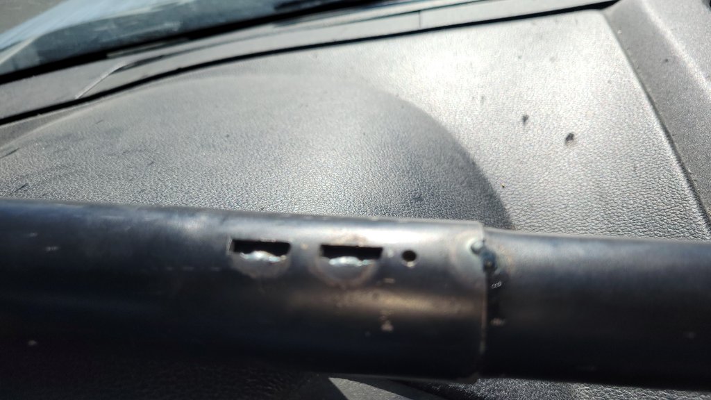

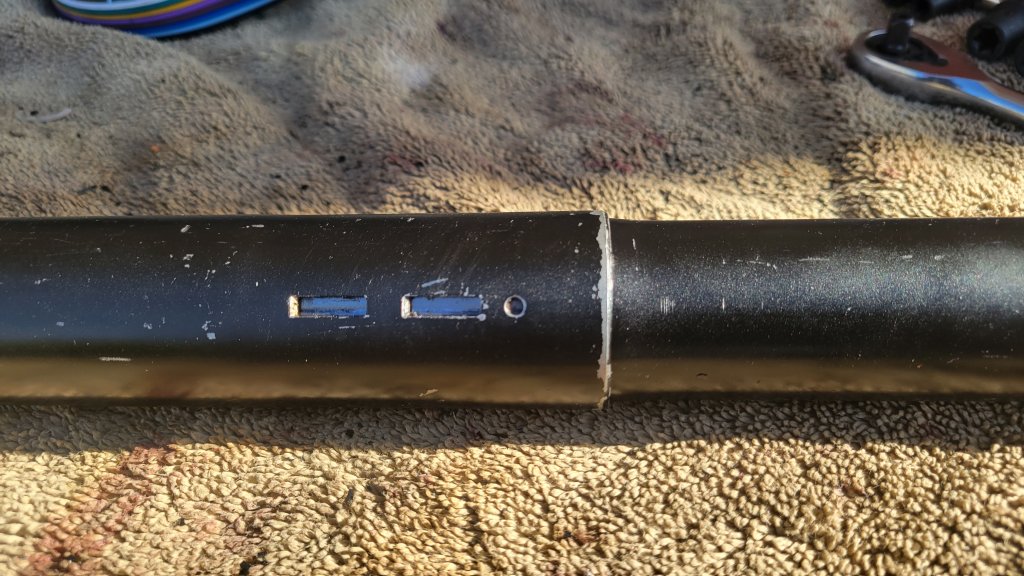

Raider L
Sep 1, 2020
1,892
1,001
Shreveport, LA
William
355
@Dieslie212,
It's my understanding that these two tubes need to be separate so that the inner tube, which turns in shifting, must not be welded together. The outer tube with the slots in it is exactly that, the outer tube that all the upper parts attach to, i.e. lower column housing, upper column housing. I've had mine apart as well, although it's been a very long time, and yes there are tow soft plastic "shims" inside and yes, they do have to be kept aligned while putting the two tubes together. It's a pain but necessary in order for the "collapse" part to work. I might be wrong but I don't think you'll be able to shift if these two are welded together.
CalSgt
Oct 3, 2021
1,688
3,706
CA
Casey
Chevy K-10 Custom Deluxe
@Dieslie212,
It should shift just fine, just won’t collapse in a hard collision. The two piece design is only a safety feature and has little to do with operation
