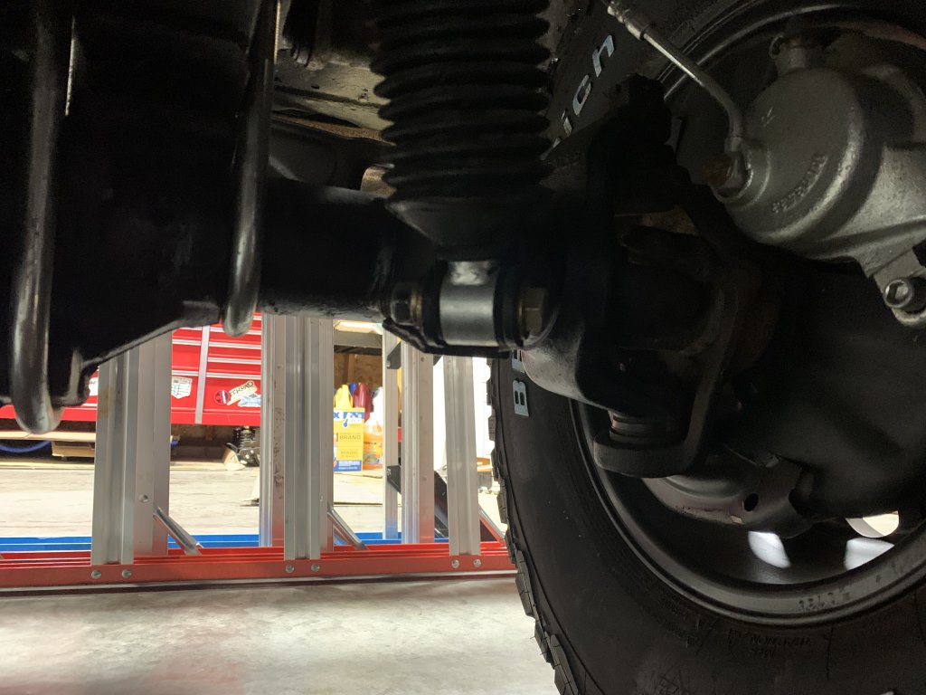

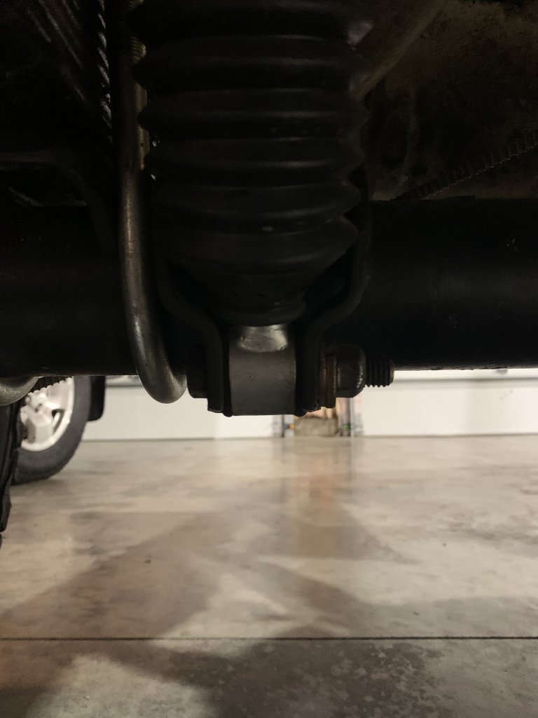

Here’s the front and rear of mine. Believe I got new grade 8 bolts. But don’t remember any issues. Old bolts were destroyed anyways.

I don't have Bilstein shocks yet, my Ranchos are similar issue front and rear. If the stud or bolt fits inside the rubber bushing without a sleeve so be it. I don't have sleeves, makes no difference. The fronts had a lot (1/2") of space between the ears. I just used 3-4 washers on each side. That's enough to minimize bushing deflection but there's no need to torque it IF you're using the metal type lock nuts like the OEM. I think your alignment guy is overthinking it, probably for liability reasons.

No sleeves in mine. That front lower looks squished bad. I don't see them lasting very long.
Agreed…

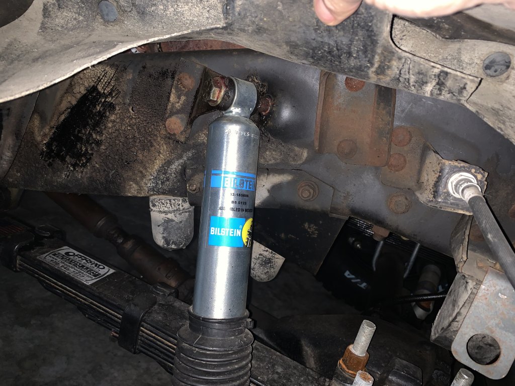

Thanks everyone for the input! I agree the front shock angle looks concerning. However, this is the angle I get using the auxiliary mount on the top and going inside the lower mount, which is what ORD said you are supposed to do. I feel like the only way to correct this is to either use the other upper location, or go outside the lower mount. I also had to grind the upper mount to clear the body of the shock, but that wasn't a big deal.

Might want to check with the ORD guys but usually single fronts go in the other front shock position. That would make the angles better on the bushings.

When you ordered the lift and shocks, did you specify use in that shock location? The standard location is the other one and probably where your shock needs to go. The aux location uses a longer shock.

Mine is that other mount to.

When I ordered the shocks online there was nowhere to specify on the website during purchase between dual and single front shocks. The only options were whether you wanted to get their extended front shock mounts (and I assume longer shocks to accompany them), which I didn't get. At the time I didn't realize that not all 4X4 trucks had the dual shocks. When I received the shocks I emailed to ask why I only received 1 set of 33-185590 Bilstein shocks (8.13" travel) front shocks and that I needed 4 for my truck. They said you only need 1 set with modern tech and that it should be mounted on the further forward (auxiliary) location, as it's more vertical, and inside the lower mount. I emailed back after I installed them and included pictures of the install. I said it seemed like the angle was wrong as neither of the stock shocks were mounted with this configuration of mount locations. They said it was ok and that the bushings can take a decent amount of deflection. For the record, I'm not trying to speak negatively of ORD as they are clearly more versed in off-road and these trucks than I am. This truck will be my first foray into off-road adventures, it just didn't look right to me and I was curious if other installs looked like this as this seems like a very popular shock and lift kit.
