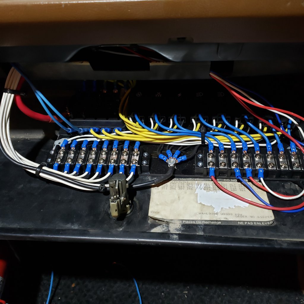

Could build one of these too. The left side is power to relay and right hand side is power out from relay. Since I don't smoke the USB cig lighter and battery monitor went onto the astray. Sorry don't have a picture of that but can get one. And put the whole thing in the glove box.

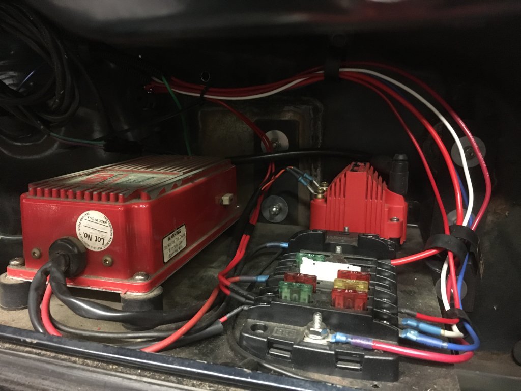

Blue Sea offers a lot of fuse panels, I just added one to my Blazer that had 2 sections- 1 12v constant and 1 12v ignition.

I don’t have any hvac parts so I built a shelf behind the glove box.
