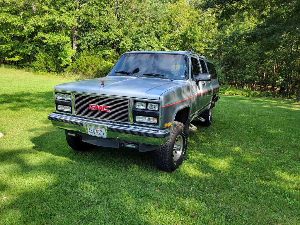

I dont have pictures of the trimming. you only have to trim to fit a 90degree bulb. if you use the straight 9006xs and 9005xs straight bulbs they come with you don't have to trim at all. I still run the 9005xs in the highs because they are actually plenty bright and you would also have to trim some from the core support to fit a 90degree bulb in the high beam. I run the 9012 in the lows and only had to clearance the bottom of the bucket with a die grinder. I run some 6in DD wide pattern fog lights and I've considered switching to the SL1 bulbs in the LMC housings to have the headlights and fogs be the same color. I just wondered how the cutoff would be and don't want to blind oncoming traffic..

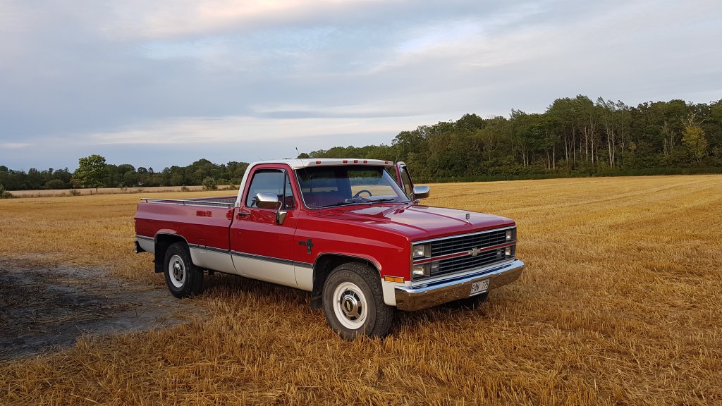

Wow great. The RMS Lighting ones have just what I was looking for, the original look when off. How is it, they come in two versions, one that has option dimmed/ not dimmed for the upper ones and one with just "full light" for the lower ones?
Runs with a well working fully rebuilt 6.2 diesel and TH700 R4. Wonderful truck, have had it for 20 years now. Frame off restoration 4 years ago. My daily car all year around.
