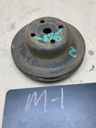

Look people this is easy. No need to spend $600. Spent a total of 30 seconds. This may be the correct pully if it was on a long later water pump. Being 2 grove, it probably was. Contact the seller for more information [what it is specifically from] and get a depth measurement. These pulleys aren't rare. There is likely 2-3 at the local pull and save yard.
I can understand that. They aren't rare in the wild in some places. My local yards didn't have them. Can't find them new easily. I am still unsure how it would have 2 different size pulleys going to the same waterpump and not cause an issue. I ended up going to a new pulley that is all the same size. They are all the larger size that used to just go to the alternator. Had to upsize the ac belt a little, but the rest of them worked stock. New harmonic balancer, new front main seal, new crank and water pump pulley, and new belts. Squeak is gone. Runs good. Still has a little bit of a wobble on the crank pulley. Not sure if this is normal. The harmonic balancer is steady and not wobbling at all. Just the pulley. Not as bad as the last one. This is a new pulley too. Here is a video of the wobble:
Let me know if that looks normal.

The 2 different diameters have the same overdrive/underdrive.
As long as you got it fixed to your satisfaction that all that matters.
Reason I got a little short was no reason to spend a bunch of money on a complete drive/bracket/pully system when all you need is one pully.
Doubt the alt will be spinning as fast as before. If battery drain become an issue some other GM brands had very small alt pulleys, such as Olds and Buick. Think they were around 2".
Glad you got it fixed, have fun.
I don't think the alt will have a problem. It is on the same size pulley as it was before. It is the same. The other two got bigger instead of making the one smaller. If I do have an issue, I'll be asking for advice on a small pulley alt to grab from the yard. I am glad it is fixed. Just don't want that wobble to be an issue long term.
