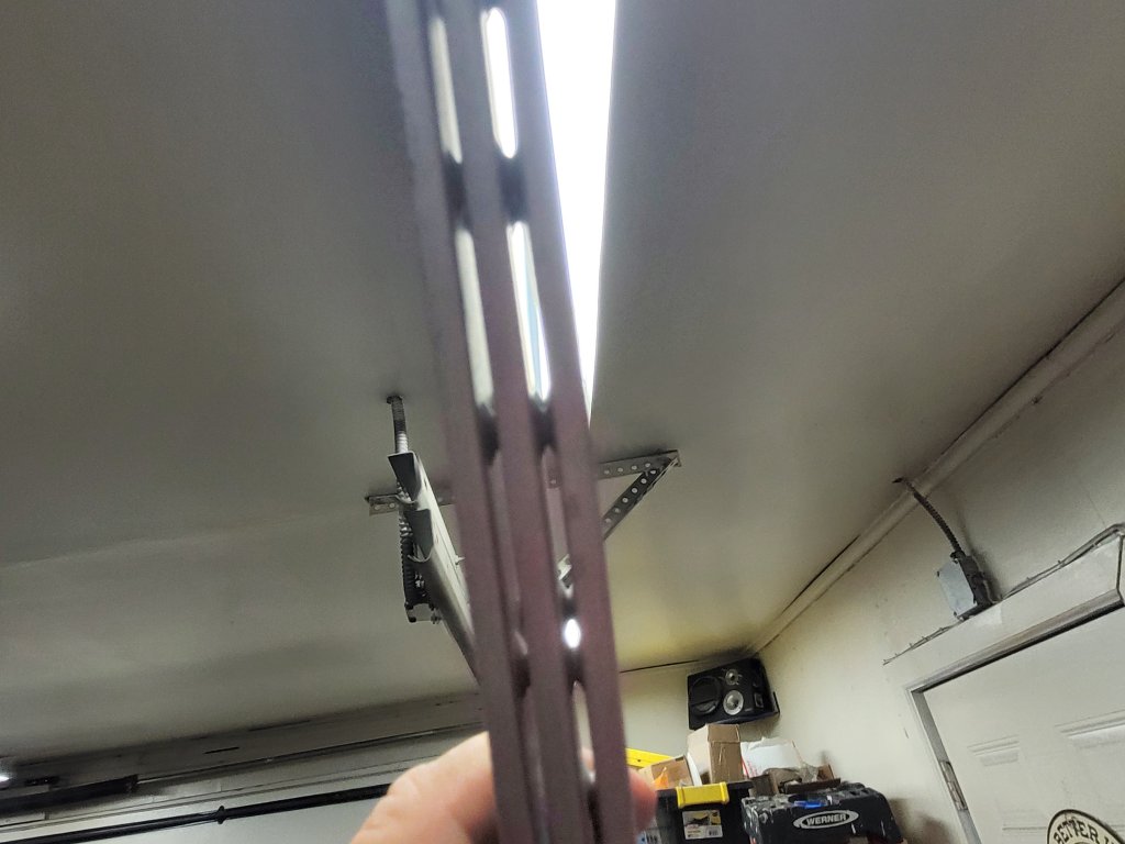

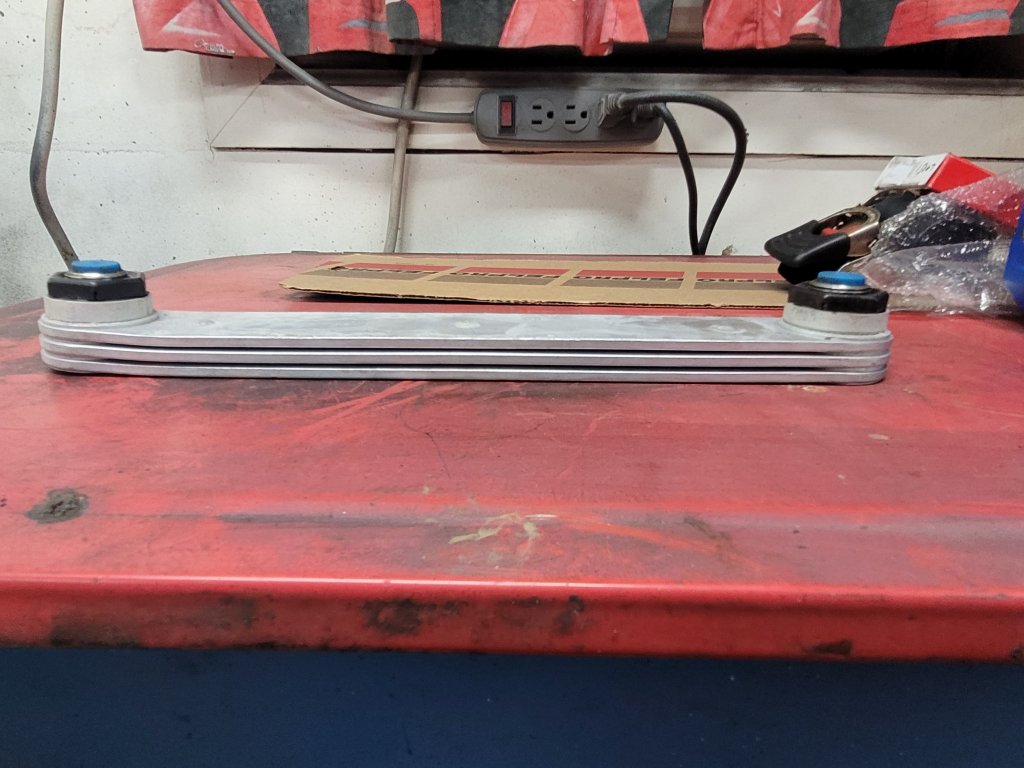

Here's the pictures of the cooler I was asking about. I am having a hard time convincing myself that it won't work. It sure looks like it would to me.

It's not going to not work. It just won't be very effective. It's better than nothing, but if you're going to go to all the trouble why not put in a proper cooler and get all the benefits.
I know. This one was free.
You're right, thanks.
