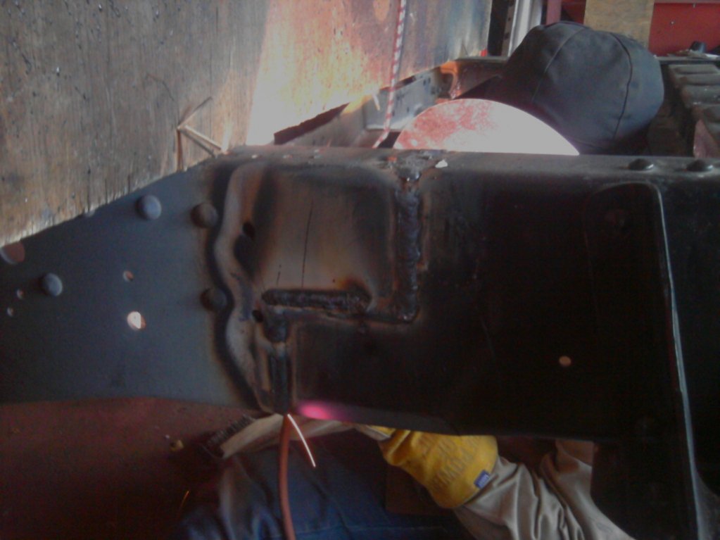

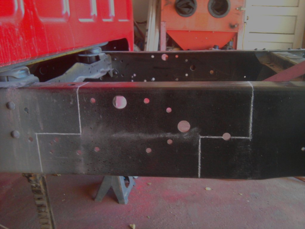

I did the long to short bed on my crew cab
Seems easy with every thing i have seen and read. Car fix video explained it pretty well.
If I end up with a long bed, im going to do it like yours and not just cut vertical.
^^^^...and thats the proper way to cut the frame. Not only is it much stronger, it also keeps it lined up properly. :)
