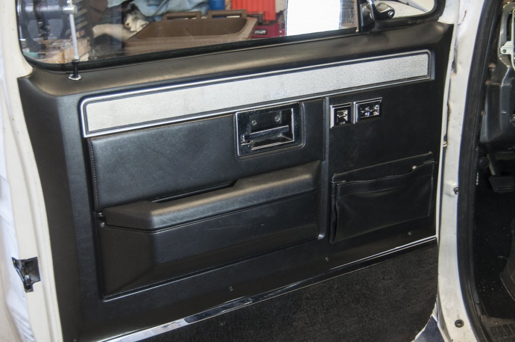

i found a rare vinyl insert (insted of velour) and i made a good style door panel ;)
