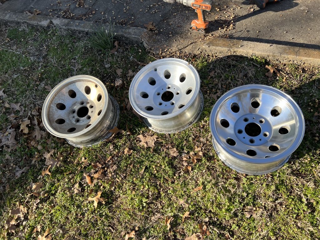

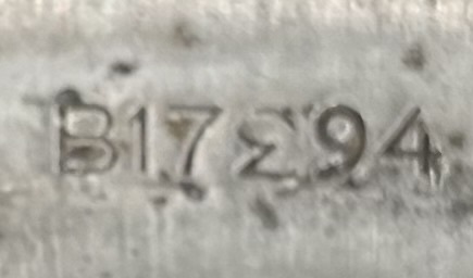

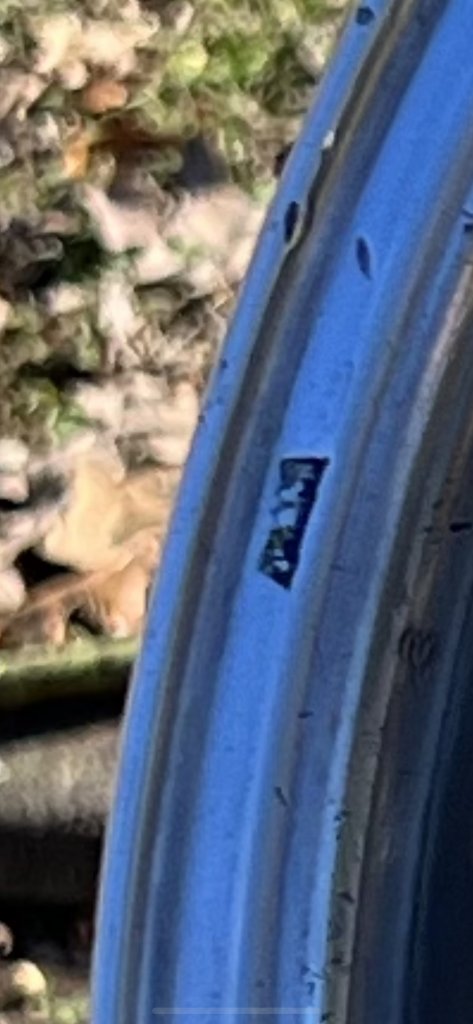

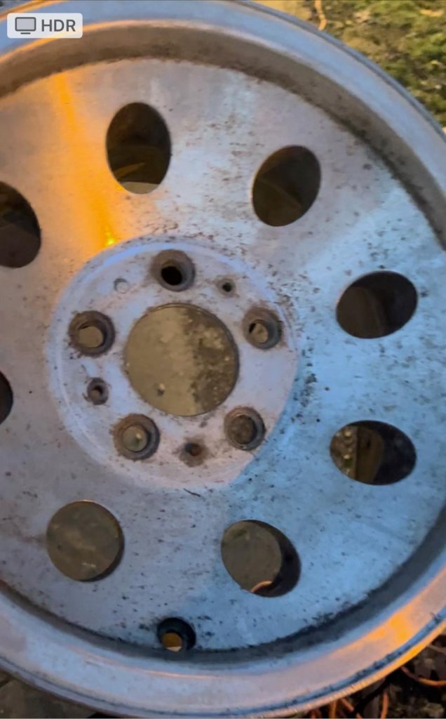

I'm in the process of working myself to death polishing a set of these. Did GM make these or did they have them made by a aftermarket wheel company? Do they have a name or part number??? There is a mark on the backside lip that looks to be AA. And an stamped number with an upside down number???
Mine had no clear coat.

All GM wheels were made by an outside supplier, like "Motorwheel" or "Alcoa" or Kelsey Hayes, etc.
I do not recall who made these; I do recall there were two version. Early version was forged, and then at some point they went cast as a cost savings.
K
American Racing also made some of the GM aluminum wheels. AR may have even offered some designs to GM but never sold the exact same wheels from their own line. Probably an agreement to GM that any replacement wheels were only bought from GM dealers.

How can you tell if they are Forged or Cast?

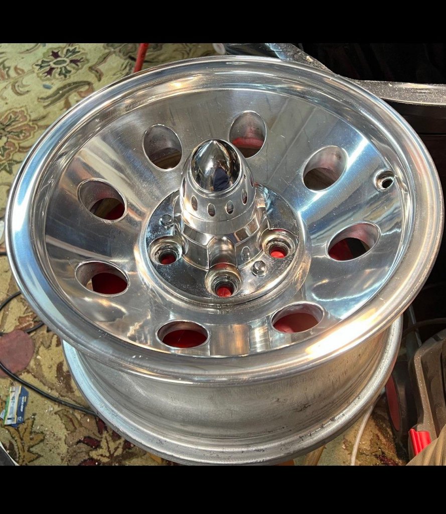

Try sanding and polishing 5 of these alloy wheels and 2 of those alloy bumper ends. Damm I wish I had before pictures
