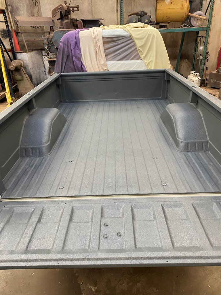

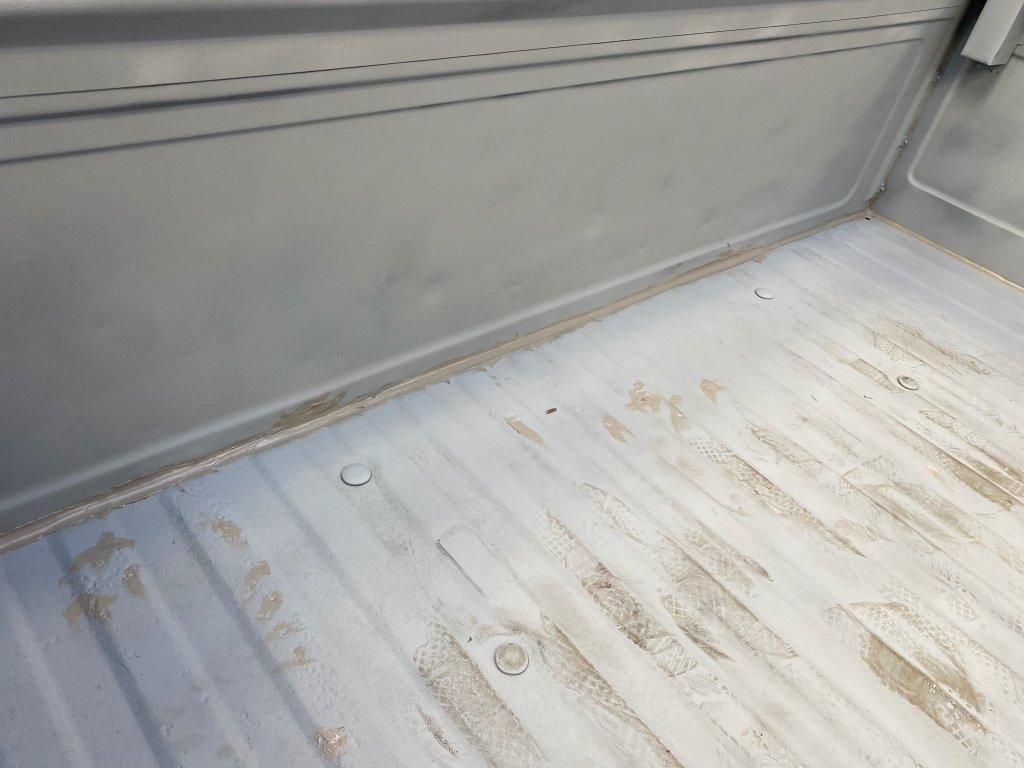

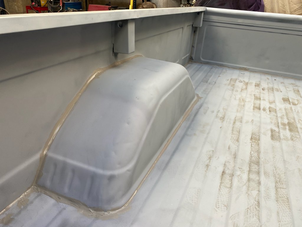

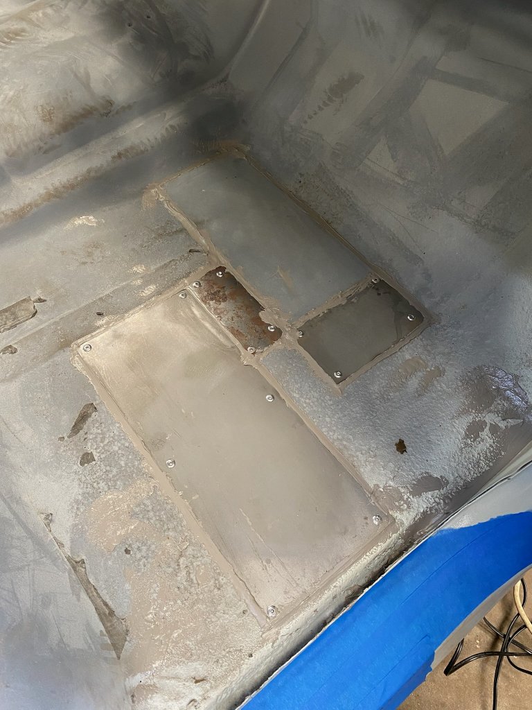

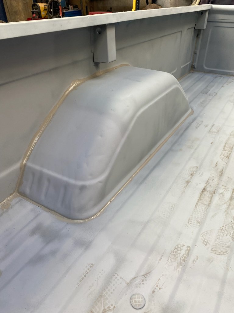

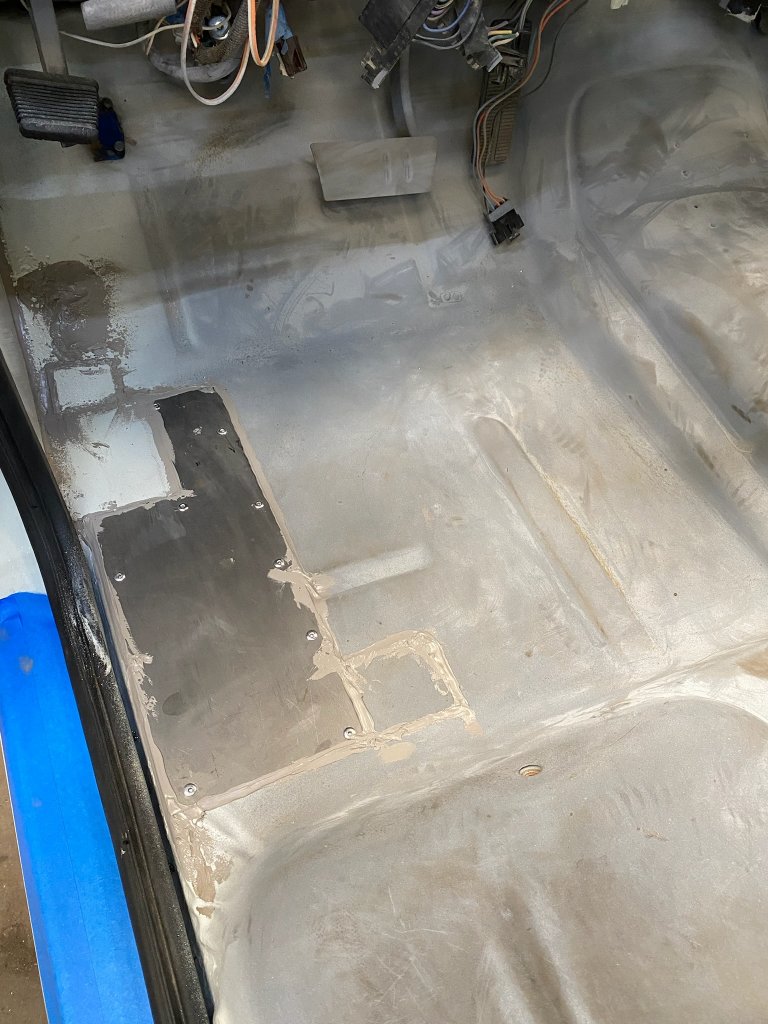

3M is great stuff we heard but an old timer in our area recommended NP-1 and that’s what we used a few years ago. Several here said not good to use for the application for various reasons, but we were not building show truck and didn’t know any better at the time. The NP1 comes in all the colors, and available at Lowes or HD About $7 a tube. Used it on floor repair in cab and to seal bed. We then used raptor on bed over the NP1. So far (2 years almost) with extreme temperature swings here in DFW all the seams are still perfect for whatever its worth.

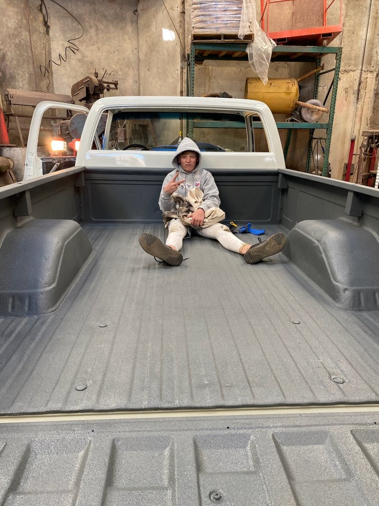

A few pictures with raptor liner on it
