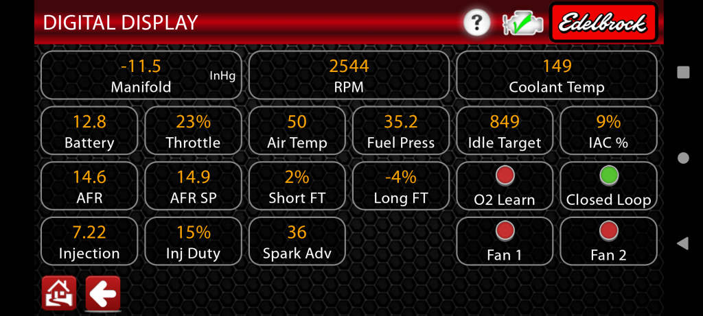

That's my theory anyway. Maybe someone can give me a sanity check. So on the way to work this morning I am going around a bend in the road at about 45 mph when all of a sudden I had no brakes or steering. Thank the good Lord there was no oncoming traffic in the opposite lane cause I shot into it trying to get stopped. Apparently, when I let off the gas the engine died and I didn't realize it. A dead engine and hydroboost make for a hell of a workout! Luckily I turned the key and she fired right back up and life went on. Wondering what happened, I opened the efi app on my phone to see if something weird was going on with the IAC. Everything looked good, then I noticed the coolant temp. Huh? 149? That can't be right. Nope, the Dakota Gauge says 151. Two gauges and different senders say the same thing. How the H*LL can that be with a 195 thermostat? Now granted, it was 41 degrees outside, which is cold for us desert rats.
I drove the remaining 20 miles to work without issue except for the mess in my shorts however, the coolant temp never got above 158. So-I'm guessing the thermostat took a crap and is failed in the open position? When I got to work, I let it idle and it slowly got up to 197 and stayed there without the fans on.
Am I crazy or is that the only thing it could be?

No knock sensor. If the temp is below 160 it runs in open loop and based on the fuel map that's programmed. I'm not sure that I have ever tuned the map at this temp before so it might be lean. It's rare to get 40 degrees here.
That all makes enough sense to be the culprit. Coolant temperature has allot to do with everything lol

Im trying to think of some other reason it did that other than if it was running below the specified CL temp,its gonna probably be in some sort of OL enrichment the entire time, making it load up and be gassy. But only being a little off from say, 160-190 wouldnt make it run that badly. Is there a target AFR for that thing based on coolant temp?
and with the air temps being real cold, it might be putting more than usual timing in it, assuming the IAT offsets are setup in the EFI.
4,188
7,998

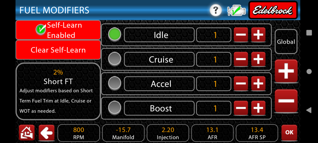

AFR is irrelevant until it goes into CL above 160. In OL, it's all based on what the map is programmed too. For the most part I have populated that map based on drivability. My guess is it's lean at idle based on temperature. Like I said, today may have been the first time it's experienced these cold conditions so I didn't know it was lean. I'll bump up the idle fuel a bit and see if it happens again. Once it's in CL, the AFR setpoint will do it on it's own. It usually hits 160 pretty quick. Without the thermostat issue today, it has never happened. It's fascinating learning how EFI works.
