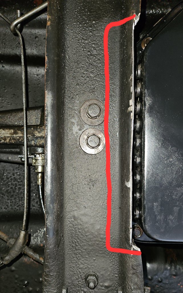

Has anyone replaced the tranny cross member with an aftermarket unit?
I'm getting fed up with the tight space between the cross member and the tranny oil pan. I put on an aftermarket oil pan and now it's impossible to get to the back 2 bolts without jacking up the rear of the tranny and removing the tranny mount.
I know there are aftermarket cross members.
What have ya used and what would you steer clear of?
Thanks.

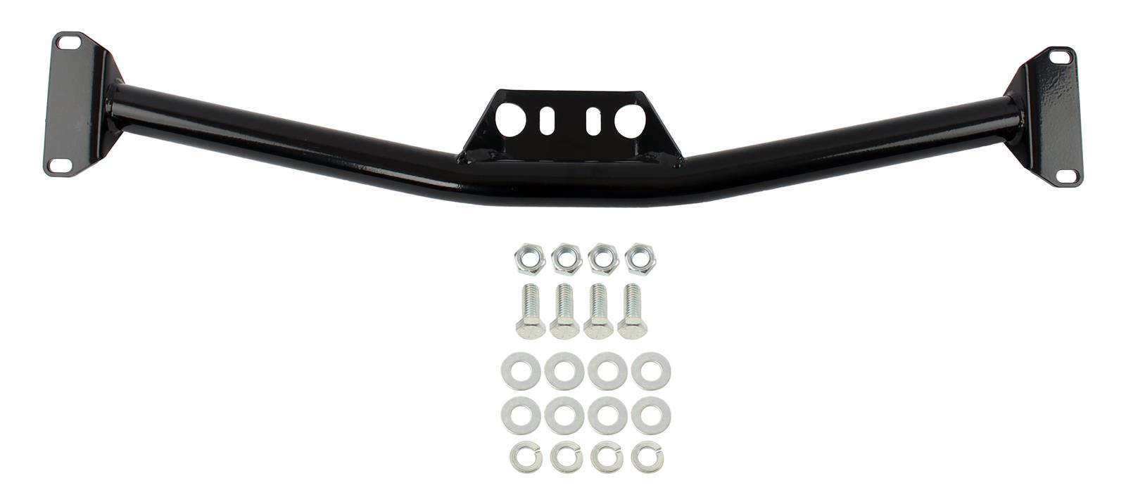

I got this from Summit. No complaints.
