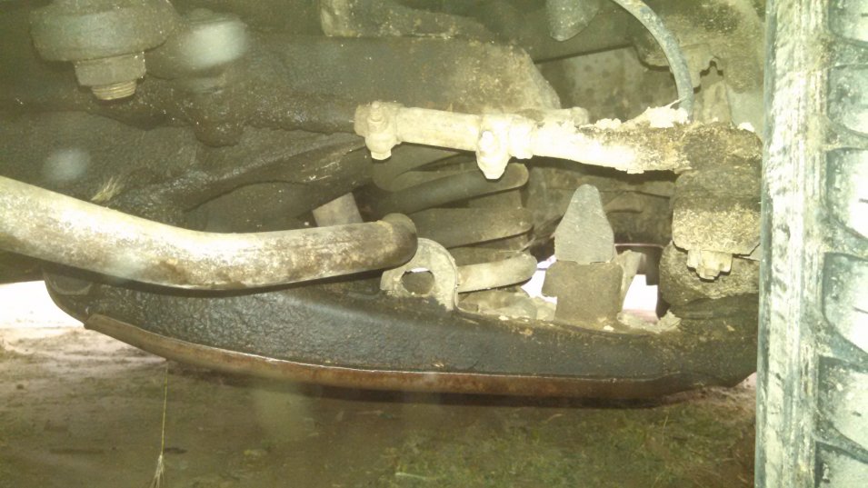

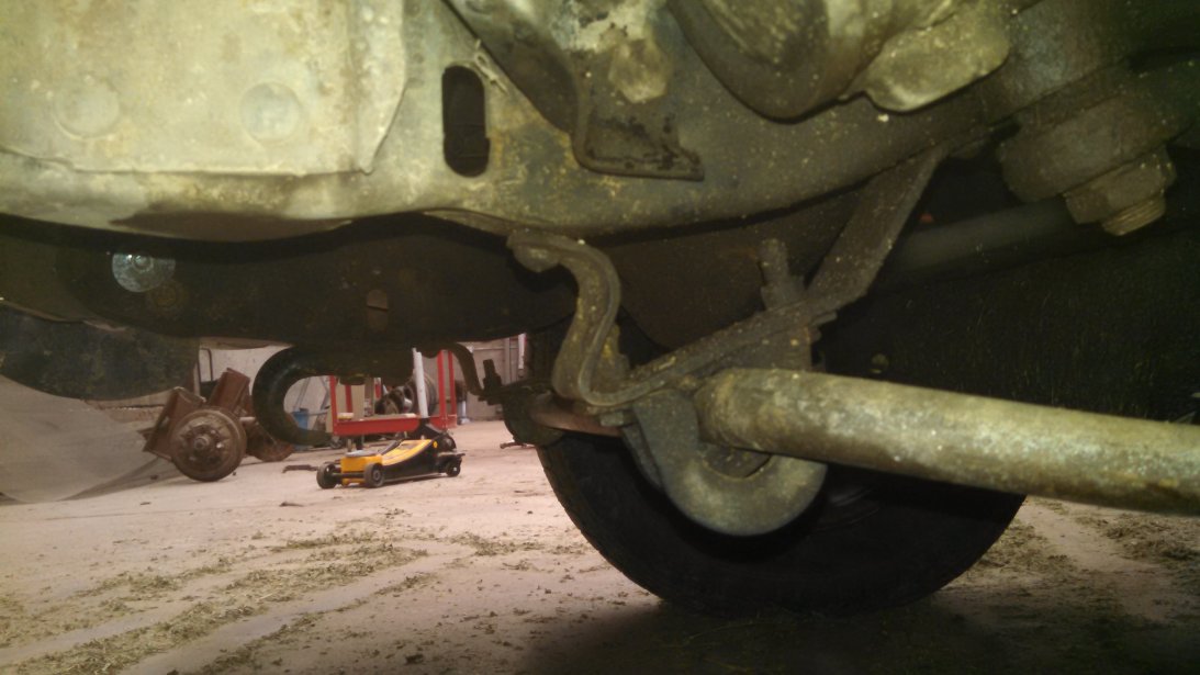

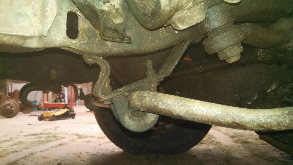

Here are some pics of the issue...

ouch, someone hit something good. get one from a junk yard or make your own. highdesertranger

Ya I agree you will have to go to the junk yard with a 2lb BH and a cold chisel so you can knock the rivets off and punch to punch them out.
Then just bolt them in on your frame with grade 8 bolts

Previous owner's landlord was drunk and put it through a ditch and fence and 'ripped the power steering pump off'. I was just curious if someone already made something boxed, rather than fabbing a boxed mount.
