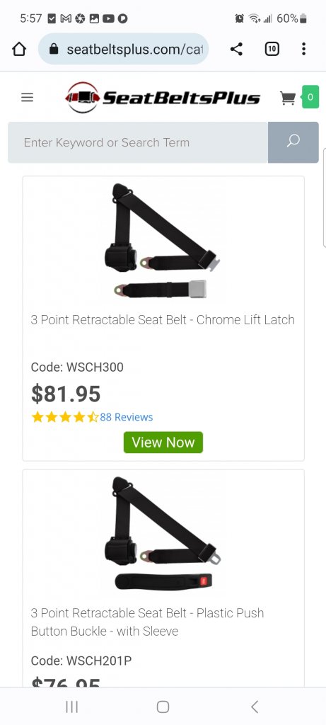

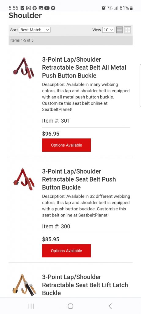

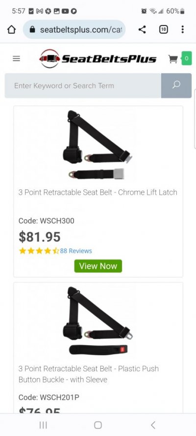

Seat belt planet or seat belts plus. That was just a quick browse. I've been looking at them for a different car just haven't gotten serious yet. They sell universals,direct replacement and repair belts. I think the universals are going to be the cheap way out. Or like when my son was maybe 4 I got in the car and he had ratchet straps wrapped around him and his car seat,he said it was better because of how many he used. Dammit I wish I'd taken a pic. Trying to put up links,no luck.
These are direct fits not universals,the universals are cheaper.
