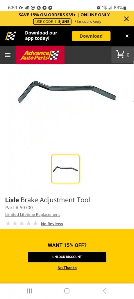

There is a tool commonly referred to as a “brake spoon” but it’s not dramatically different than a double ended screwdriver except for the fact the ends are bent at 45 and 90 degrees.
5,382
8,582
Here's a visual for you

The adjustment tool is kind of a generic tool meant for most cars. Not all cars had self adjusting brakes as late as 1979 for sure in the U.S. but it's a great tool for turning the adjusters back in for taking off brake drums.
