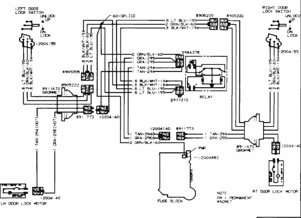

I have a Viper 3100 kit on my 85 C10 Silverado with factory power locks and noticed the instructions call for a negative input and output to operate the door locks and to purchase an additional relay if the circuit is positive.
Is the factory system already a negative feed? If so what wires do I need to tap into? Thanks.

After doing some probing I have found that the black wire with a white stripe going behind the driver side kick panel and into the door unlocks the doors, and the light blue wire in the same place locks it. They only get hot for an about a second or less when the switch is applied in the direction corresponding to the wire.
4,180
7,970
It's a ground triggered system. The orange/black is the only hot wire on the load (actuator) side. Everything else is ground on the control (switches/relay) side. You want to tap into the control side, the Tan and Gray wires going into the relay.
