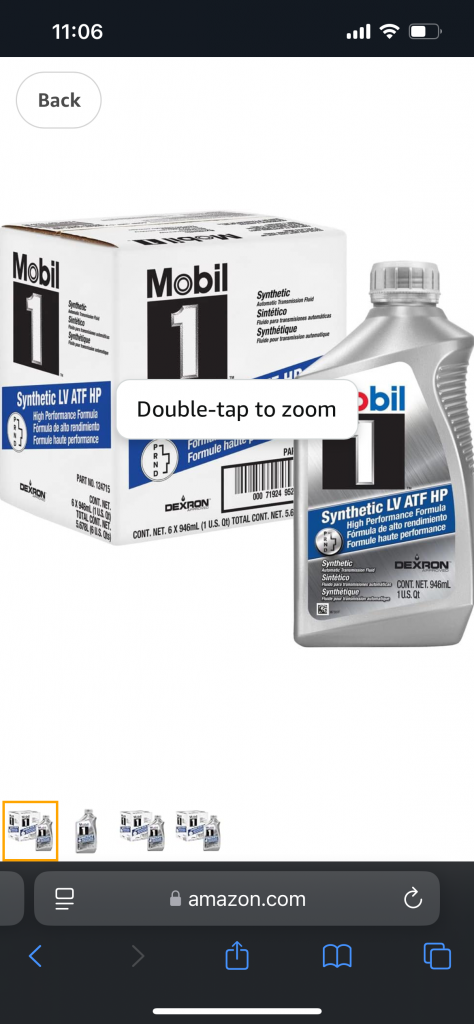

Not sure about yours, but my 2017 Colorado started with the shudder and according to GM I needed to change the Transmission fluid and install Mobil 1 LV BLUE LABEL......has to be the Blue label. So, I did and the shudder is gone. Drained it 3 times, made easier by me installing a drain plug in the pan. Just my 2 pennies......YMMV...........and mine was at the 90,000 mark
