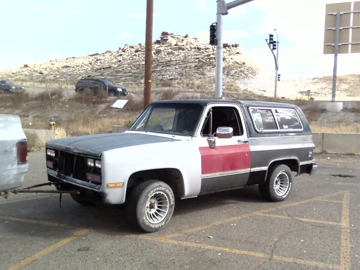

tis is my 82 blazer with a 86 body I done the swap to it and a 85 I have

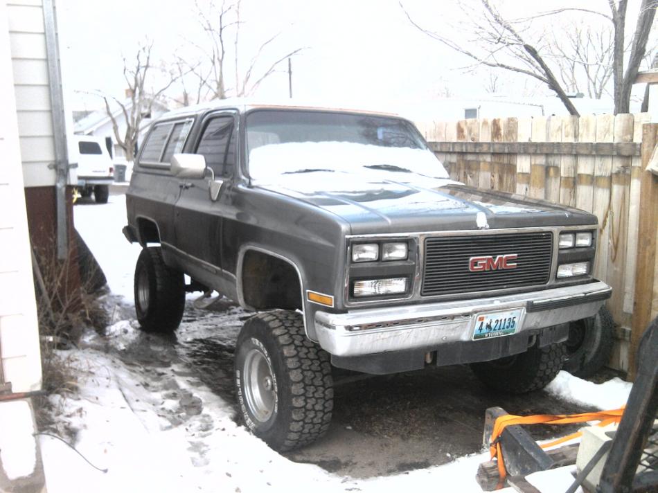

and a pic of my 90 jimmy to show the gmc grill

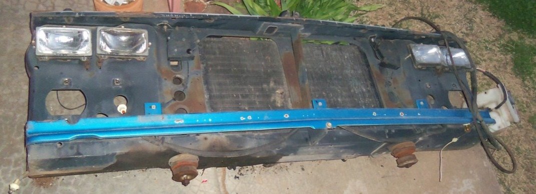

Core Support and I think the valance too. get the wiring too and it's easily adapted your current harness.
