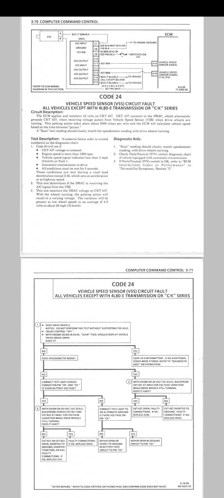

does your speedometer work?

but EGR does a self test and will throw a code. usually on highway at steady throttle it does the test. it would be code 32, though...
