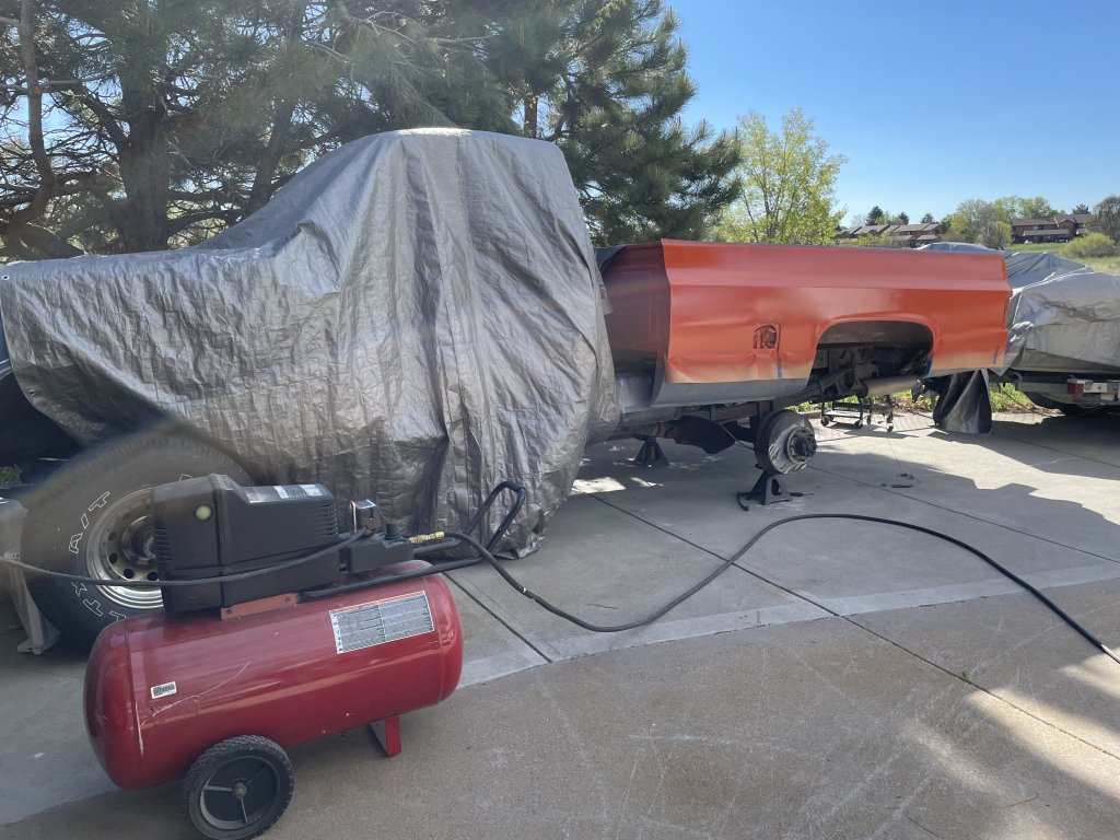

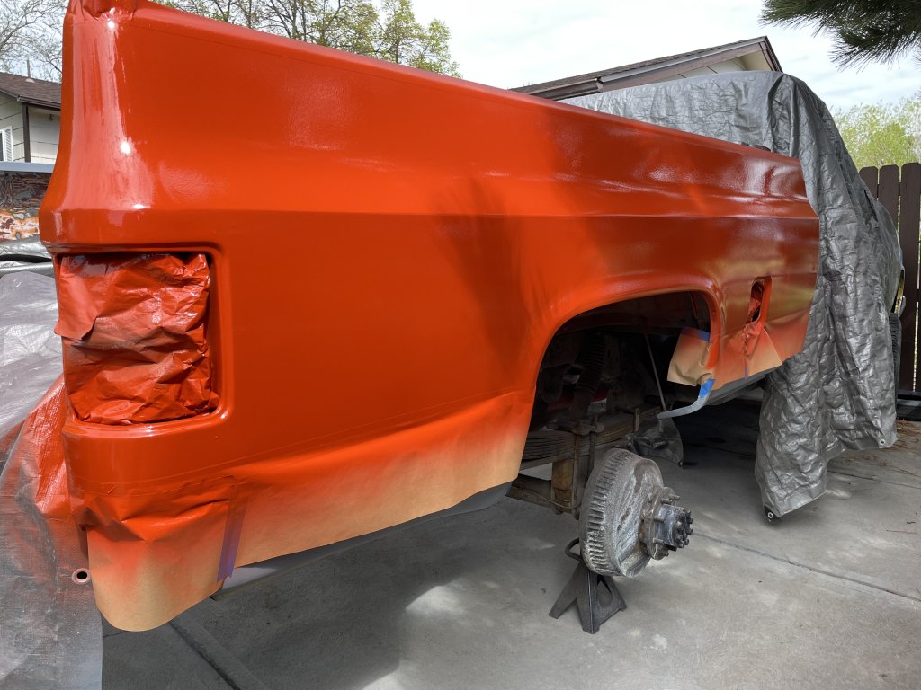

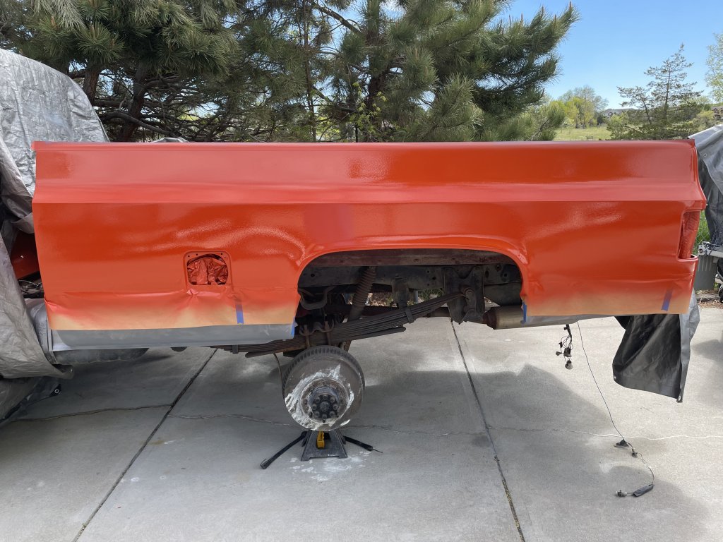

I’m currently using the panel by panel approach, mostly because my compressor won’t keep up with the whole truck approach. It’s not a show truck so I’m good with however it turns out. A couple years in the natural elements should result in a uniform look anyway. Anything you can accomplish on your own will save you money, assuming you know what you’re doing.

Thank you Ricko, do you have a hack for a paint booth since I have been using Mother Nature’ paint booth? Never considered a water heater, too late now since I already painted 1/2 the truck. Your problem solving skills are outstanding, I enjoy reading your responses, always spot on.

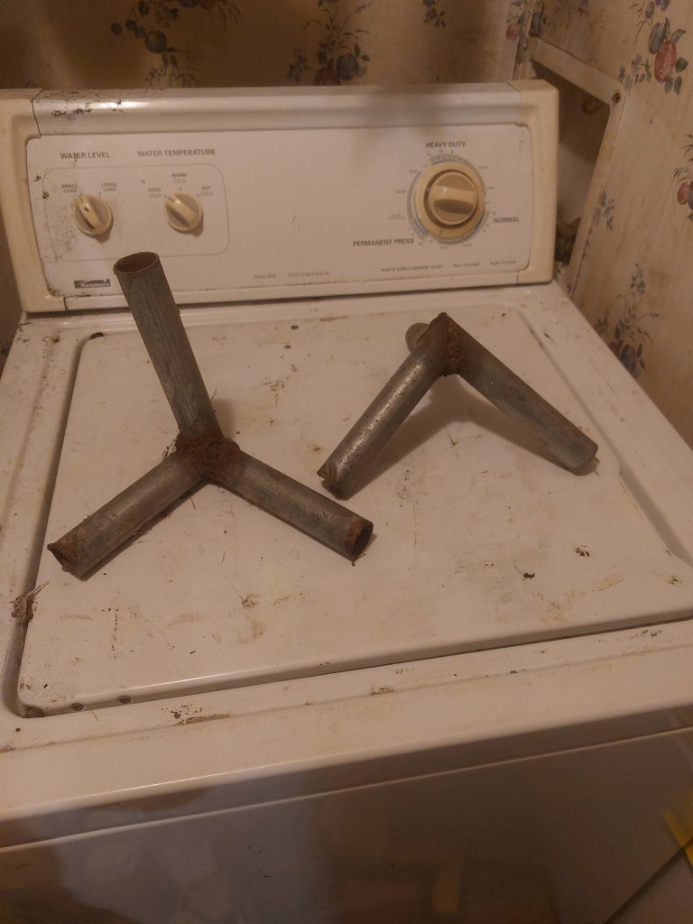

Yes, busy right now but a crude paint both can be made with conduit,tarps,furnace filters and box fans. More details later busy busy.
5,416
8,630

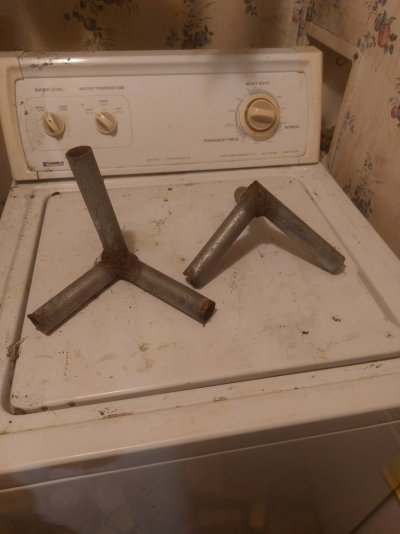

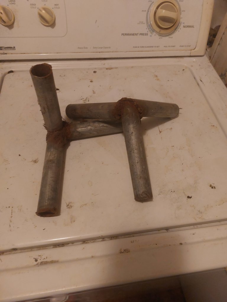

@mxer147 I did almost this exactly except outside it's been 20 or 25 years ago,sorry no pics. But the fittings he says he bought,I just made them,I'll take pics tomorrow,actually probably Sunday,gotta find them and I'm busy tomorrow. You just use the next larger size conduit cut and weld slip the smaller pieces in and sink a self tapper to hold everything.Grind away the galvanizing and do the welding outside. I'll look for my fittings to show you,and put up pics of the fittings,probably be Sunday. Anyway here's a link for you. You actually could just do a lean to style and make less fittings and use less conduit,don't know why I didn't think of that before. http://www.wendels.com/55chevy/booth_constuction.htm

I welded together pieces of conduit then slid pieces of conduit inside to make a conduit shed skeleton then skinned it with tarps and zip ties,box fans and furnace filters on 1 end blowing through for ventilation. That post I put up from that other guy,I like his skin better, clear plastic drop cloth and duct tape. If you need pics of the rest of the pieces I can drag them in and shoot pics. But I think just the 2 should give you the Idea.
