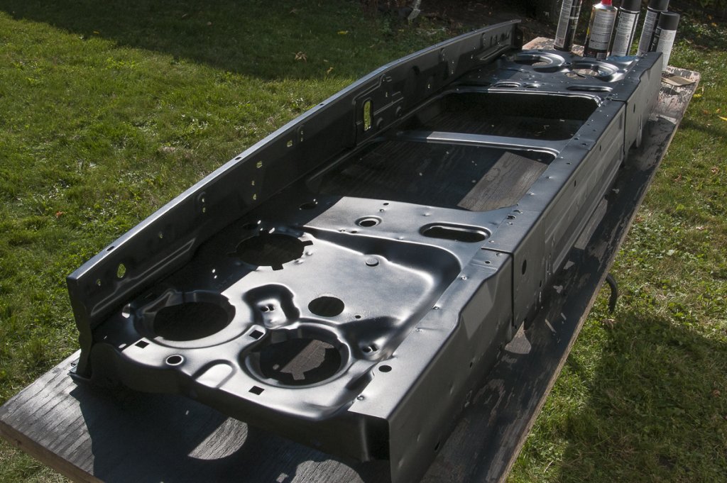

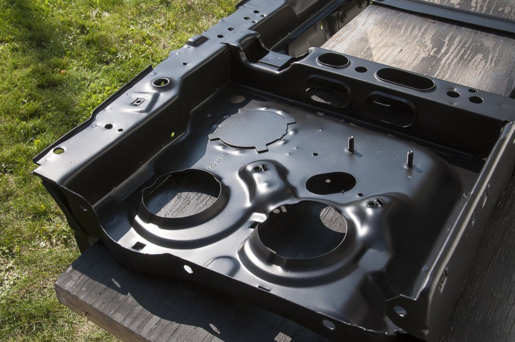

Here's the differences between the core supports.
Dual Headlights
Quad Headlights

not the same light pod from 2 to four ;)
