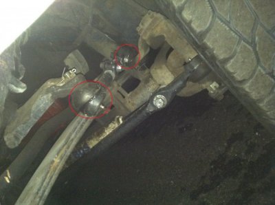

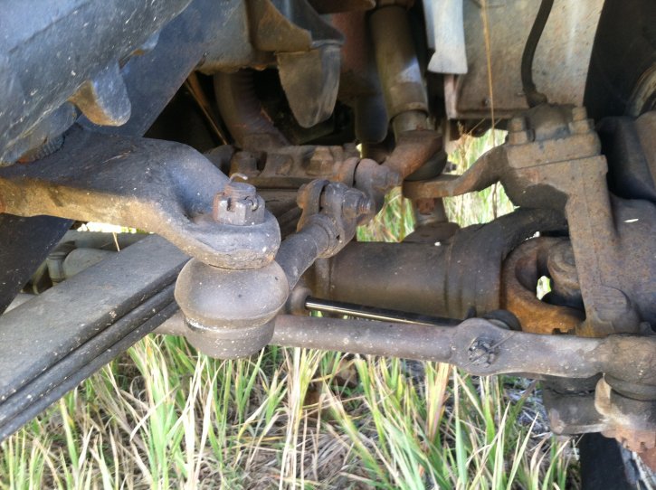

i had the broken steering parts replaced. my mechanic said all the seals n kingpins were new. replaced output seal on tcase. completely rebuilt front drive shaft. new rear u joints. drives great but 1 out of every 10 stops it still death wobbles real hard left to right. happens around 25-50mph normal driving speeds. doesnt seem to matter how hard or easy i brake or if i down shift or neutral or clutch in or out. just have to ride out death wobble once it starts. im having it aligned on tuesday hopefully that solves some more troubles. i attached a photo and my concerned are the joints inside the red circles at the correct angle. my other k30 has these joints sitting flat not ****-eyed. thanks for the help

those tie rod ends sit where they want. are they tight? if there is no play in them they are not your problem. you have another problem something is out of spec or loose somewhere. btw it's almost time for tires that could be part of the problem. highdesertranger

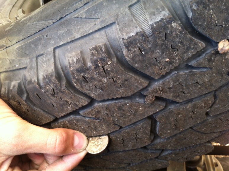

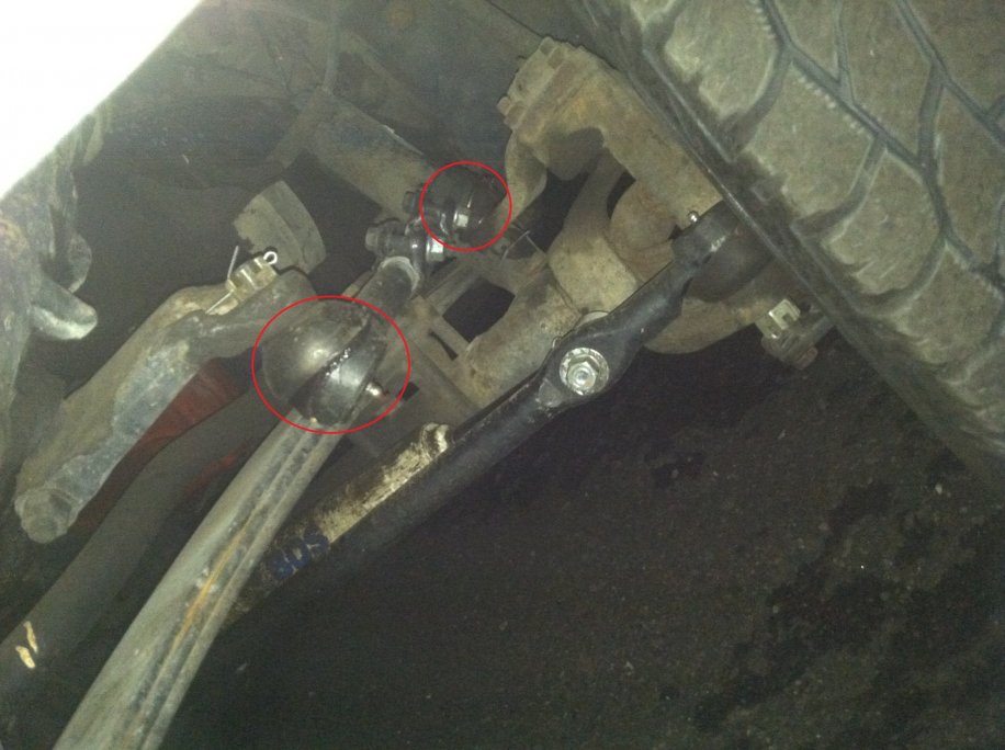

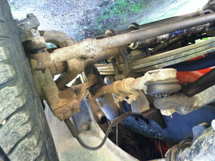

how do i check if the tie rod ends are tight? do i need to jack up the front axle? my mechanic said everything is tight up front, he recommended the alignment and possibly a dual steering stabilizer. from what ive read the dual stabilizer is just masking the problem. could i have bent the new tie rod ends during a violent death wobble? seems like the front tie rod end pictured is bent towards driver side and the rear tie rod bent towards the passenger side. im attaching another pic of my other k30 dana60 to compare. maybe its just a bad pic because the tires are good. i greased everything i could after driving for a week or so. ujoints upfront are all new

Alignment shop called today and they say the front leaf springs bushing are too worn to complete the alignment. Gonna get new leafs, bushings, and grease able shackles from off road design. Anyone ever heard of leaf spring bushings causing death wobble? Maybe it's causing the poor alignment which in turn is the main cause of the death wobble?

Play in any parts can cause some funky steering issues such as bump steering and death wobble mainly because the steering isn't in full control of the wheels with the extra play.
Worn spring bushings would allow the axle to possibly twist and shift from side to side enough to cause issues. In turn, it wouldn't be able to guarantee that the alignment would stay true throughout all situations.

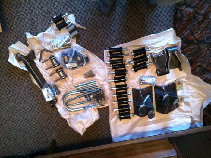

Makes sense. Thanks for the reply. I'm Replacing the leaf springs n bushings and upgrade shackles and new sway bar bushings, steering brace... All the good stuff from ORD. Im looking for advice concidering a lift of 2" - 4" since I'm buying new leafs. How much lift till my drive shaft lengths come into play ? Around 4" -6" is what my research is saying. I don't mind new brake lines but would like to leave drive shafts n e brake alone. Leaning more towards 2" lift springs upfront n 2.5" shackle flip in the rear. I don't want to cause more steering problems or vibrations trying to solve the death wobble.

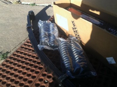

Some of the new parts came in
Lu Blunt
Jun 6, 2016
191
130
Rye, CO
Luke
350ci
Front leafs n shocks

Since it sounds like you want to do some real work with this truck, I would try to stay with about a 2"-2.5" lift kit. Once you go more than that you need to change more parts to keep steering aligned and tracking normally,. On a work truck I like to keep it simple and reliable.
With a 2" front lift, the rear shackle flip should work, but take a look first to see the condition of your rear springs and whether they should be replaced. You might find they are in bad enough shape that they should also be replaced.

My thoughts exactly on simple n reliable. I had already ordered 2" lift springs up front n 2.5" shackle flip for the rear. Glad u agree on the 2" lift for a work truck. Also got Hd shackles, greaceable bushings, new shocks, steering brace kit, sway bar bushings.
