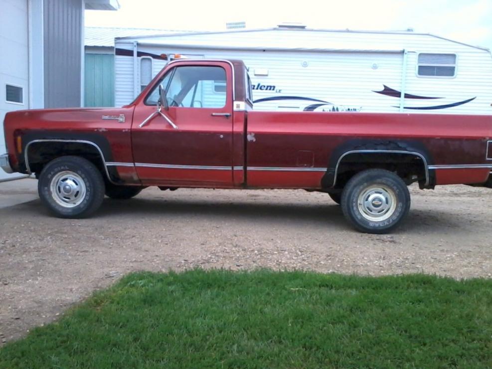

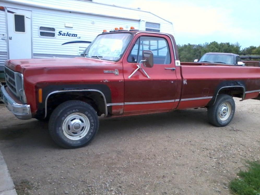

Sooooo im rdy guys, time to rip on me. #4 & #8 plug wires were crossed.....:mfr_omg: I switched them as soon as i got home and cured. Runs like a champ. I cannot for the life know were i would have done that.... cus i took one off at a time to change them out but i must have. But wat ever its fixed and im very stoked. But now i noticed my oil pressure gauge is pretty low while driveing and goes up a little when parked :help: but still seems kinda low it never goes over half on the gauge.... also my battery gauge is kinda doing the same thing..... but im sure the alternator is very old but looks clean and doesn't make any noise but when in park its up were that should be but low when driving. O and i also sprayed undercote on the wheel wells to try and stop/hide the rust and i think it turned out better than expected. What you guys think?

Awesome. Much freakin better than a bad valve. Could have a bad ground and guages are not accurate that way. Guage actually work by measuring in milivolts, some do anyway, so when a good ground or voltage is not correct it can affect electric guages. This is why I always prefer mechanical guages for my crticial things like Water temp, and oil pressure. And OEM guages usually aren't 100% accurate anyway, so what you need to get used to, is what do they normally do, then pay attention if they aren't doing what they normally do to detect a real problem.
