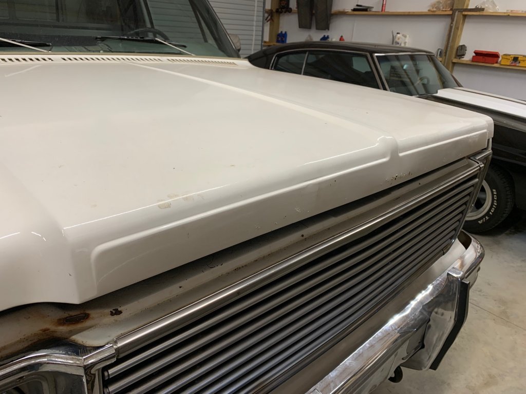

The hood looks to be maybe a 79-80?

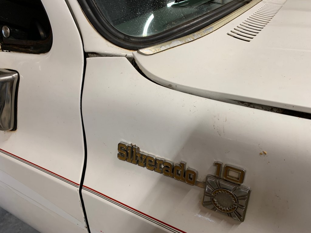

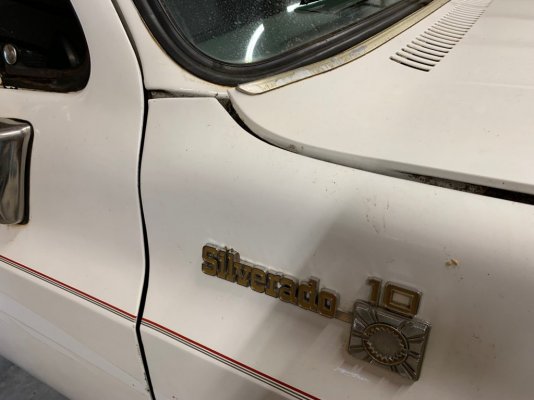

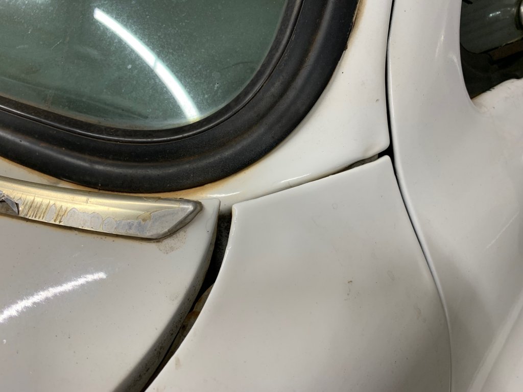

The fenders with "Silverado" may be something newer than 75? Also the fit to the cab may suggest they are 81-87 instead of 73-80 fenders? Does that sound right?

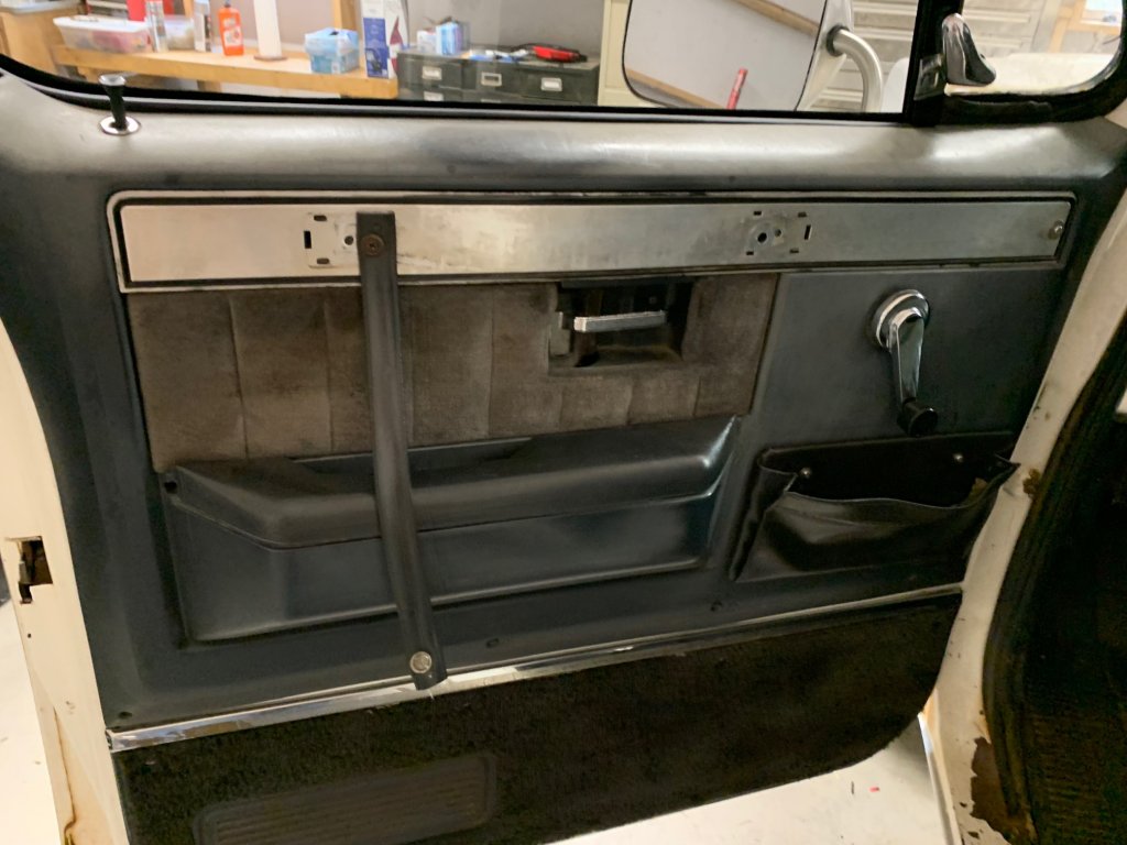

Finally, the inner door panels may suggest something newer than 77?

The door panels are for sure 80's, the hood is for sure 79-80, the fenders are mid 70's as that's what the emblem looks like, someone else will be able to get you a year range for the emblems.
That fit to the cab on the fenders is normal, thats one of the worst spots on these trucks. The core support might be from mid to late the 70's as well if there was enough damage to the front. Seems to be the pattern anyways.

so it sounds like I have nothing to gain by trying to source different / better fitting fenders, that is good. I assume to replace those fender badges the fender has to be off the truck, is that correct? (are the mounting holes universal does anyone know - meaning if I wanted to use more correct 73 fender badges).
One hood question...though the front end of it may not be true 73 correct, I am concerned about the passenger side bow in front of the hinge. I see there are hood braces. Has anyone put those on after a slight bow and does it actually draw that bow down some?

Everything @PrairieDrifter said is correct.
And yes the hood braces work. We used to put 1” angle on the hoods with self tappers before pre made “hood braces” were an item.
