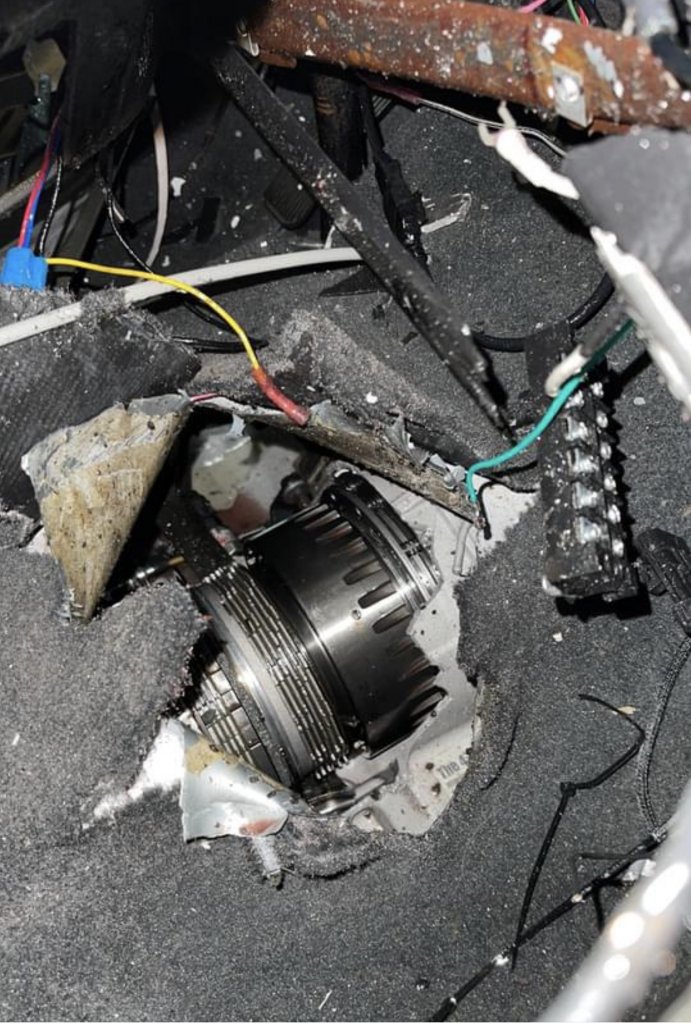

This is what can happen when the direct drum explodes.
Crazy pic!! Engine braking it is!
