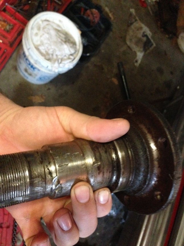

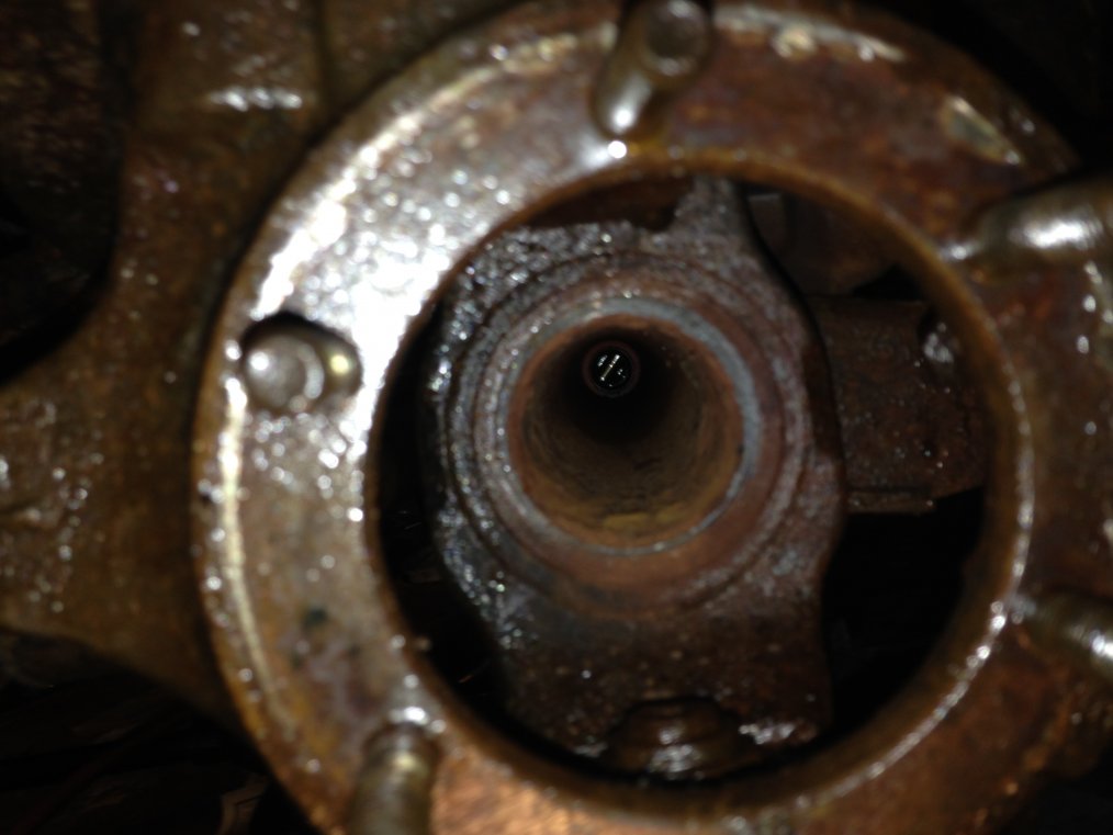

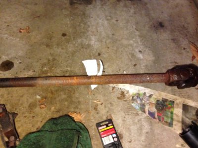

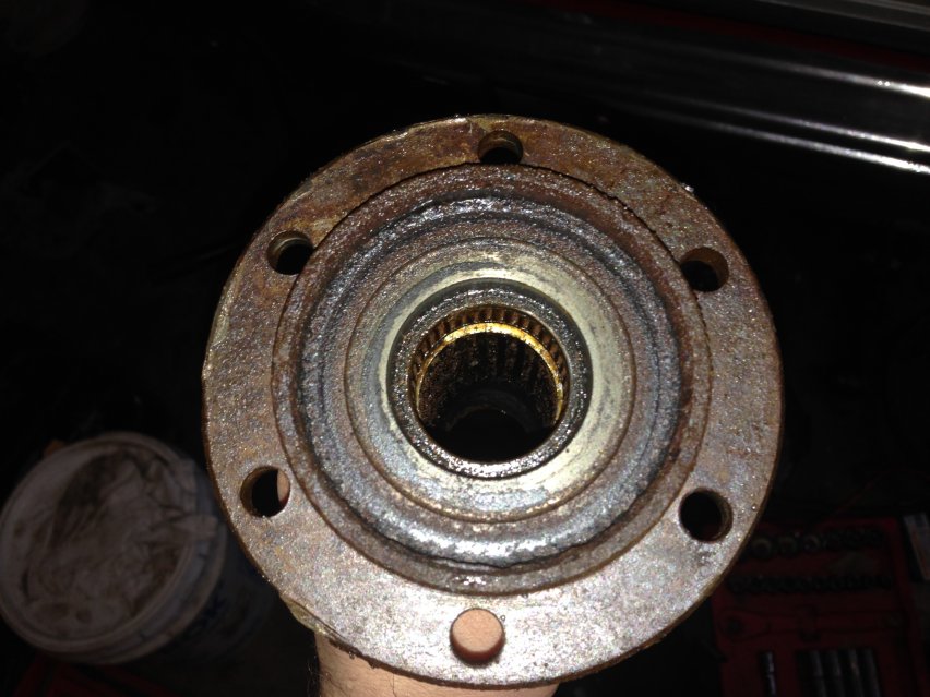

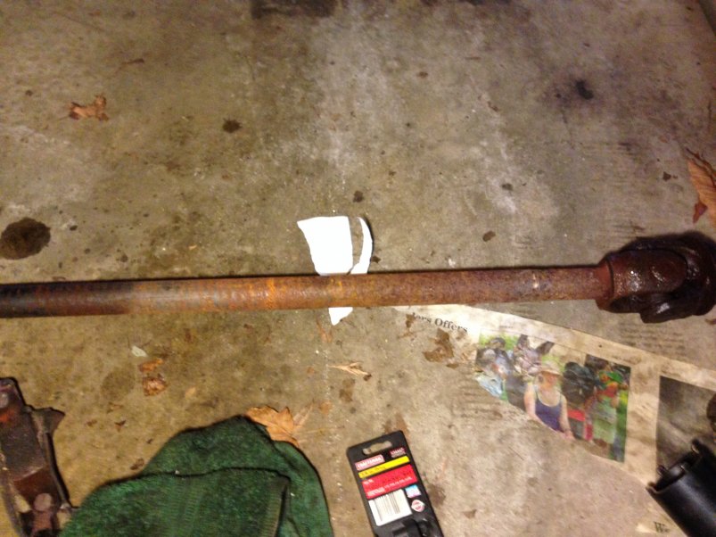

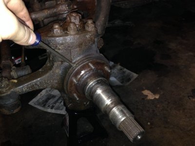

I thought doing the ball joints of my truck wouldn't be too bad but as usual I've come across a couple unforeseen issues. I'll try to document it in case anyone else comes across this. I replaced the wheel bearings and races and turned the rotors when I bought the truck about a year ago. This is my first 4wd truck that I'm working on so its a bit of a learning curve. My truck is incapsulated with a weird thick mud that dries on to an almost powder coated finish. It laughs at a wire brush and cleaning it is a very slow process.
Anyways my spindle was rust welded to the knuckle. I spent 2 hours trying to separate the two but it laughed at my rubber mallet. It was rusted on the inner part so even after it started to move it didn't want to come out. I watched a you tube video in disbelief after it came off with a light tap. My spindle is shot.
1. where can I buy a new one? Rock auto didn't have anything listed for my 87, just a seal and bearing kit. Which I definitely need two of.
The axle housing if rusty but I think it shouldn't matter. Doesn't seem to be hurting anything and after some new spindle bearings and seals, should be fixed. But any advice is appreciated. I'm going to press out and in the new ball joints today and then take apart the other side. My ujoints should be here tomorrow and I'll tacket that on the front axles. Anything else you see that I should be doing when I'm in there? Thanks in advance

here is the banged up spindle

You should be able to get a spindle at a wrecking yard. You need to be careful when you press out the top ball joint on the side with the steering arm , my press kit hit the steering arm a little bit so it would not sit flat on the ball joint so I had to dremal a little of the arm to get it in there. I have seen other people go for it anyway and break there adaptor so you may want to check that. Be careful when puting your axle's back in not to damage your seals in the diff. You wil need a small spindle nut socket for your top ball joint preload nut (under the top nut) and a inch lbs. torque wrench. Follow the insructions that come with the new joints , Torque the bottom nut first then the peload spindle nut and then the top nut etc...... I forget the torque spec's but they should be in the instructions. When you go back together with new packed bearings you need to go tight with the first spindle nut and then spin the rotor , then back it off a little but not to far to where you have play. Then put your lock ring in and then put the smack down on the outer nut. Check every thing else on and in the front end and you will be good to go.

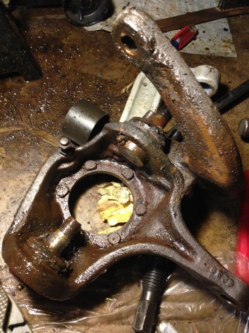

I can't get the u shaped piece on top of the knuckle, steering arm? separated from the knuckle. I tried a small torch and it laughed at it. I also banged it pretty hard when it was still on the truck. You can't get the spacer on the press over the top ball joint without removing it so that will be another pita.
The pass side spindle is just as frozen on and you can get behind it to get it broken free. I'm 99% percent sure I'm going to destroy that side as well when I put the 2x4 away and just start wacking it with the sledge. I'll post in the wanted section to see if anyone has a pair. Thanks

The steering arm has locking cones that can be a bitch , you have to hit downward on the arm to get them free , not upward. I also soak them in pb blaster before I even try.
Thanks, I've given up trying to separate them. I'll take it into work and see if I can use the press to pop out/in the ball joints. I hopefully also got a line of some spindles locally. It was almost cheaper to buy a whole parts truck that just the spindles.

Here is a tip. While the ball joint press from Autozone is workable it is a bit of a pain in the ass. The drivers side knuckle with the steering arm is blocking where the cup would go to get the top ball joint out. I brought it to work where they have a press and in 5 minutes had it out. Putting the joint in won't be a problem because the cup will go on the bottom.
