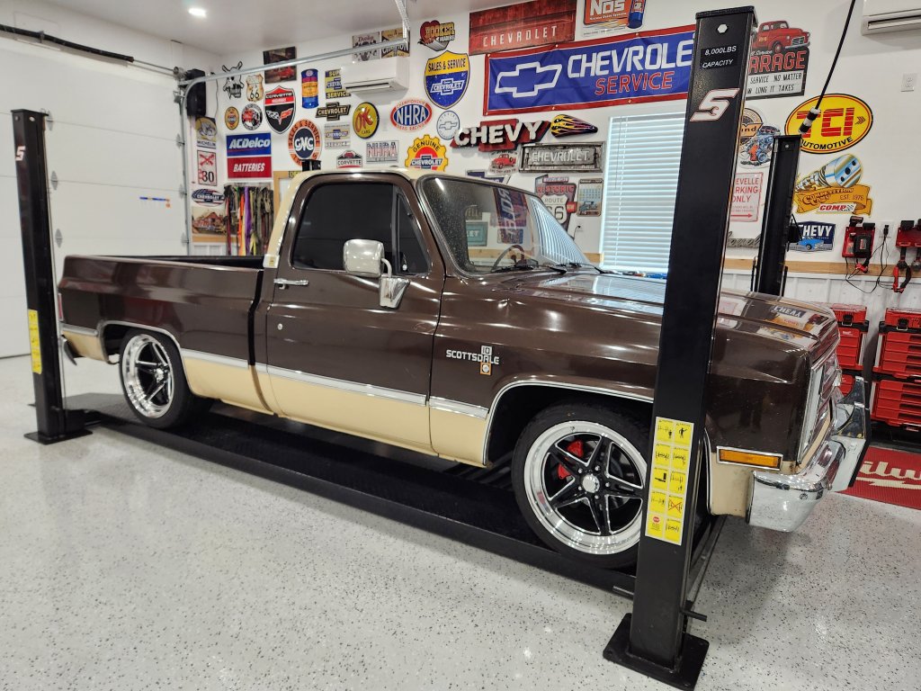

Yes, just bought this 1985 Scottsdale.

It's been LS swapped with the 5.3.
