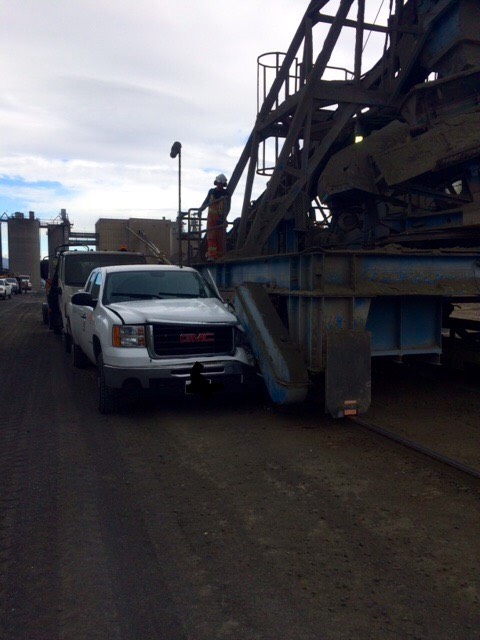

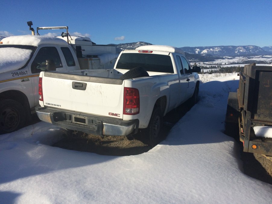

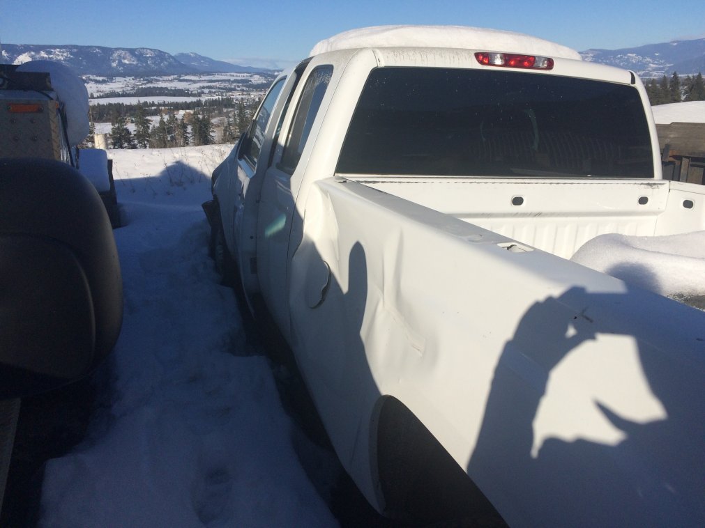

pics would be nice as well so we can see what all damage there is.

Here are the three I have. The truck was our work truck and was in top running shape when it had the accident. There is no damage to any running parts, just body, cab, box... but not worth our company to repair.
