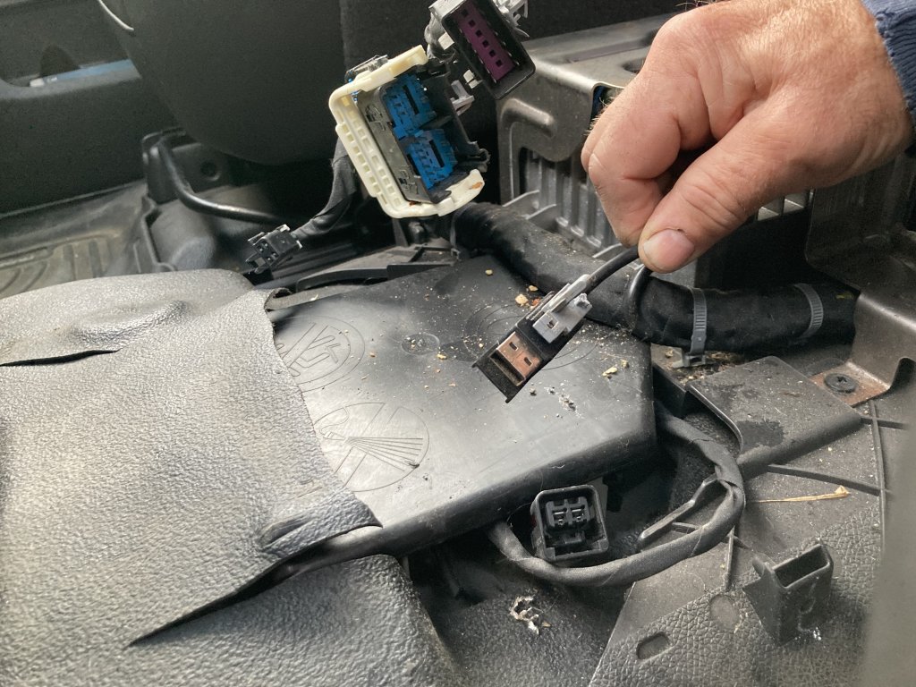

After installing a replacement adtermarket radio and replacing the Apple Play USB port with GM aux poer port I decided to see why the aux power, etc was not working in the console. Mystery solved, no harness(s) connecting the stuff in/under the console! Anyone have a clue what I need here to complete the connection to these five connectors?

Upon further digging, I see that the amp is a Bose, and my “you ess gummint” fleet model Suburban did not come with the Bose sound system. Those wires were meant for the accompanying pieces of the system. I removed the accessory power/USB wires and will power them up.
