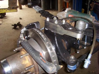

what about something like this . this was a cross over . Did you say you had a one ton front?
