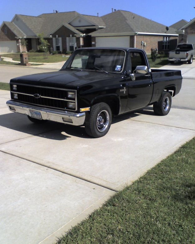

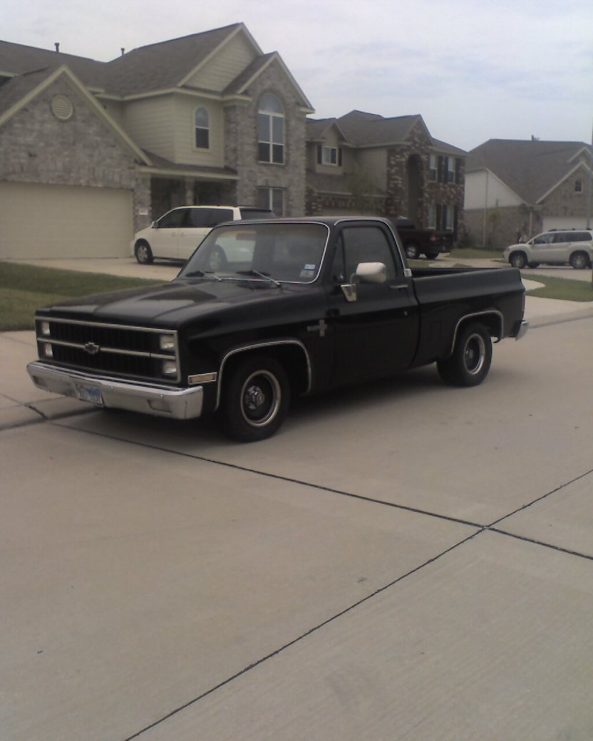

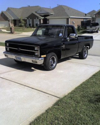

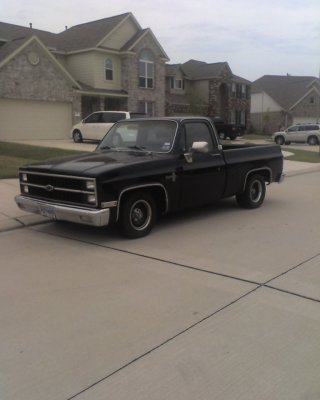

If you are only going to drop 2in in the front you really dont "need" drop spindles, you can save some $$$ and just cut one round off the stock springs. Below is a before and after pics of a 2in spring drop.
What diameter wheels do you want to run?
