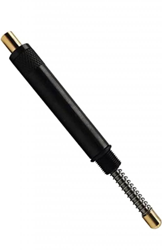

Definetly check the timing, sounds like a to advanced problem. Also make sure you are using a timing chain cover with the correct markings on it. If your motor is a Frankenstein, you may be looking at the wrong timing chain cover, or looking at the wrong balancer especially if you used parts from a 305 for a 350 upgrade. Some have timing chain covers have timing marks at 12 o’clock and some have them at the 2 o’clock-ish position. Too advanced will snap the nose cone for sure.
You can get a gauge like this on Amazon for les than $20. Put it in #1 cylinder, crack all the spark plugs and spin the motor by hand to find TDC. That will tell you if the crank, cover and balancer you are looking at belong together.

An easier way of doing this,without waiting on a special tool and just time involved. Put a vacuum gauge on manifold vacuum, loosen the distributor clamp, advance the distributor until you have the most vacuum,now retard it until vacuum just starts to drop 1or2 inches. Now disconnect and plug the vacuum advance and check timing with your light if marks are close then your cover and balancer are fine. If they aren't close run it with the timing set by vacuum until you get a piston stop. Then you can remark or replace the balancer,depending. If it's the wrong year balancer,just remark it. If it's slipped replace it. And just to clarify when you use a piston stop you go clock wise by hand until you hit the piston stop then make a mark on the balancer to line up with zero on the timin cover. Now go counter clockwise by hand until you hit the stop make another mark on the balancer. Halfway between the two marks is TDC.
