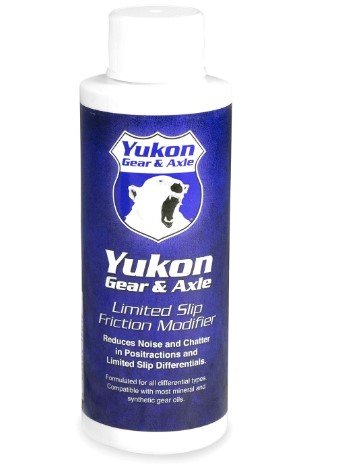

Looks like its a 14bolt FF G80.
Im going to grab a bottle of the Yukon Friction Modifier.

If it is a limited slip, you may need two bottles of Yukon additive.
I believe they recommend 1 bottle for 2qts, over 2qts may require an additional bottle.
It may be fine with one, or clutches might chatter with only one.
