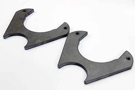

After looking up the various parts needed, I will be able to retain the 15" rims I have on now. Ive attached the weld on bracket for my axle that a tech from RuffStuff said would work. Its for the 3.25" diameter. The rotors will be from an 88+ Chevy 4x4 front.

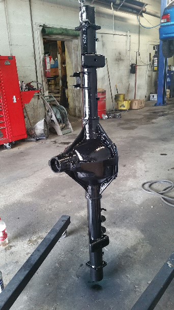

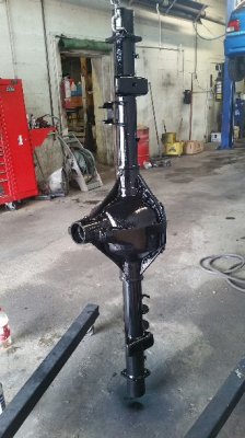

Here is the 14 bolt painted up now
