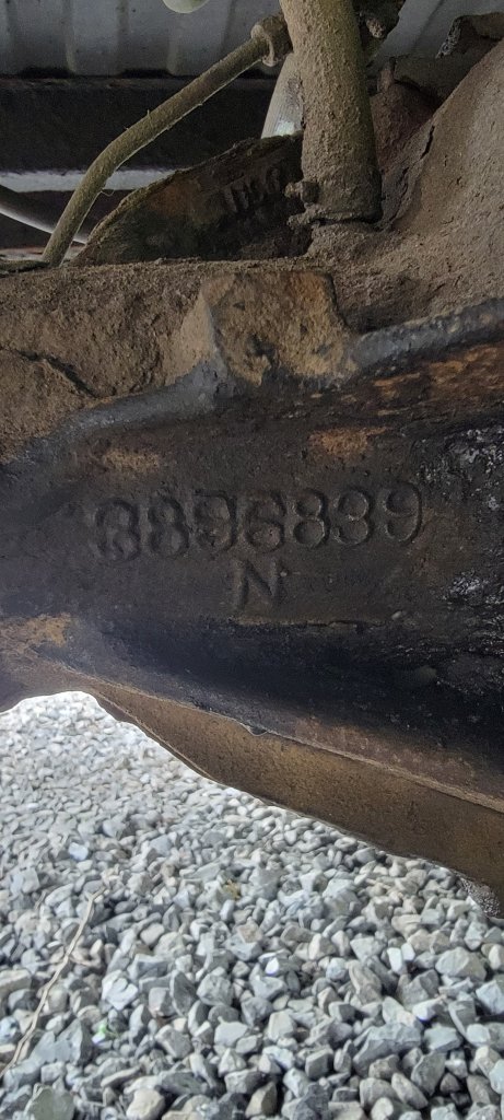

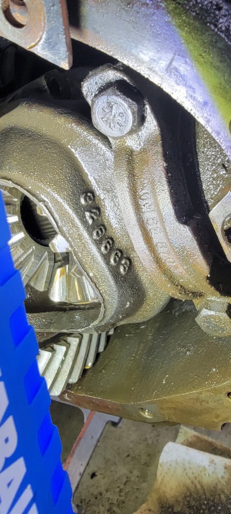

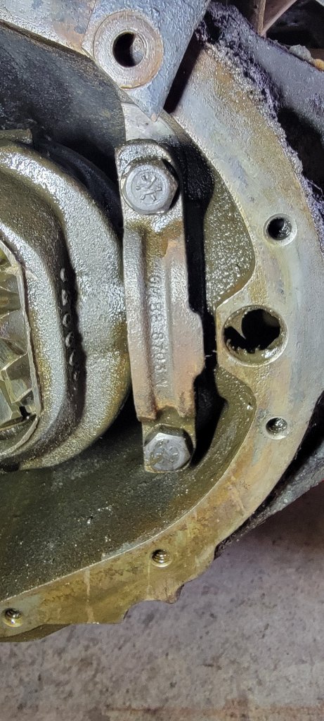

I have a 82 chevy k10 with the 6.2 diesel and i recently replaced the rear seals and bearrings and I was kinda dumb and thought I was looking at the right numbers for the axle ratio when I was in the pumpkin but after everything was buttoned up i found out i didnt have the right one. On the label that came with the truck and the specs it says i have a GQ1 - Rear Axle Standard but i have seen that it means it could be a few different ratios. I have pictures of just about every other number i could find in the pumpkin and outside. Is there a way i can tell what i have from them or not? I have read a bunch about it but i know theres a way to do it by lifting up the one side and turning the wheel but i also saw that it is not always right. Thanks in advance for the help!

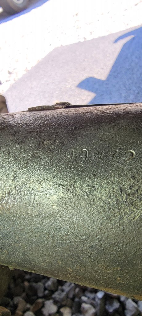

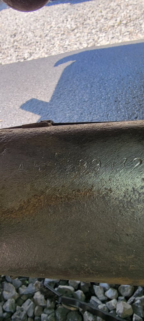

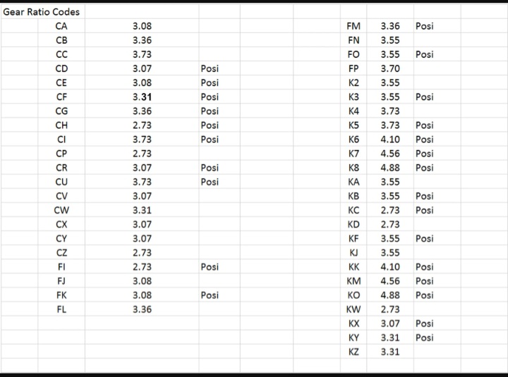

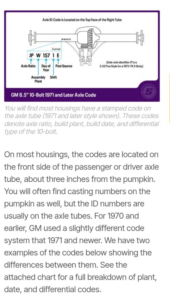

There are normally markings on the axle tubes that tell the ratio when new,Ill get you location and decode info,BIAB,I'm assuming it's a 10 bolt,which most common ratio is 3.08 12 bolt 3.07 Or you can put a mark at 6 o'clock position on one tire,as above,mark the drive shaft,push the truck forward slowly,checking the mark on the drive shaft when the mark on your tire is at 6,8,10,12,2,4 back to 6. Count drive shaft revolutions. Kind of a pain in the ass,but no more than getting out a jack and jackstands,jacking up the truck and pulling the cover or spinning the wheel.
See if you can get a code off the axle tube,post it. I'll try to identify it.

I got under the truck today and did my best to clean it off and get a decent picture. I believe the code is KAH 299W72

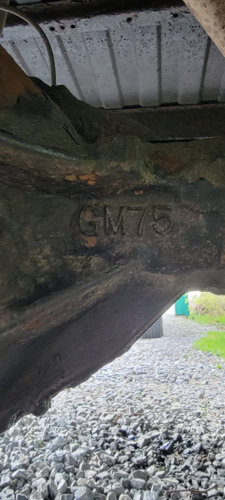

Interesting.. i see your tube says GM75
I wonder what that means. one of my 12 bolts says GM80
What is the signifigance?
