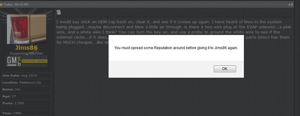

And since it wouldn't let me "give it to you" that way I'll have to do it this way, but it's the thought that counts, right?! :cheers:

LOL! Right on. I THINK the solenoid for the LS evap systems are back on the cannister.
