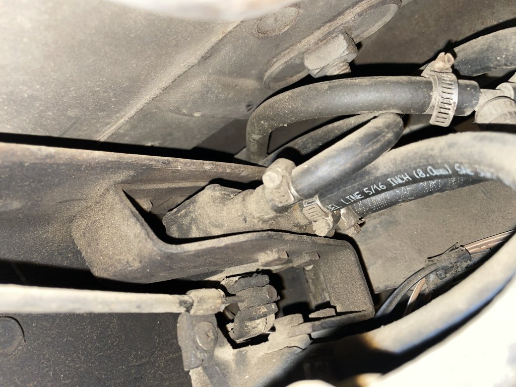

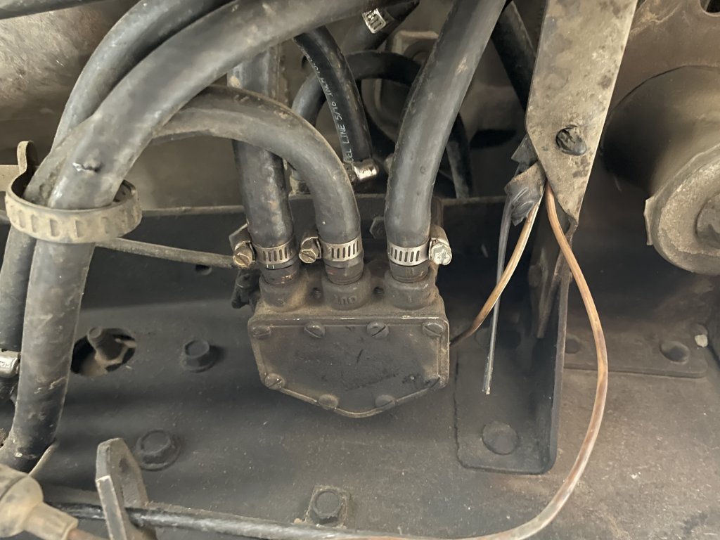

A quick set of pictures I got while crawling around on the concrete of the switcher valve. The one wire you see cut, that’s a crazy story. The fuel gauge would only work when the e brake was at a certain spot. I did check the pressure differential switch, electrical wasn’t mixed up. I did ohm checks on the printed circuit board, it wasn’t the issue as I thought maybe it bled over to the fuel gauge. I checked the sending units, ohms checked out. That wire is going to the engine compartment and then returns to the spot you see, honestly I didn’t spend time seeing where it went I just bypassed it and the fuel gauges worked since. It’s on the list of a couple other items to figure out.
thank you thats cool!

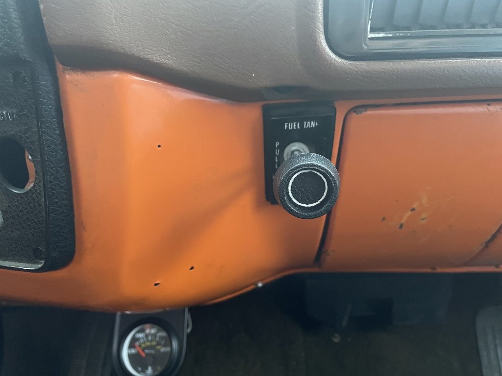

Not sure it’s the factory knob but it works. Hopefully some day in my travels I’ll find a GM parts manual to see exactly what was there. Who knows, when I pull the seat to repair the slides it could be under there. Wanted to make sure I did show the knob on, it might help someone search for this down the road.
